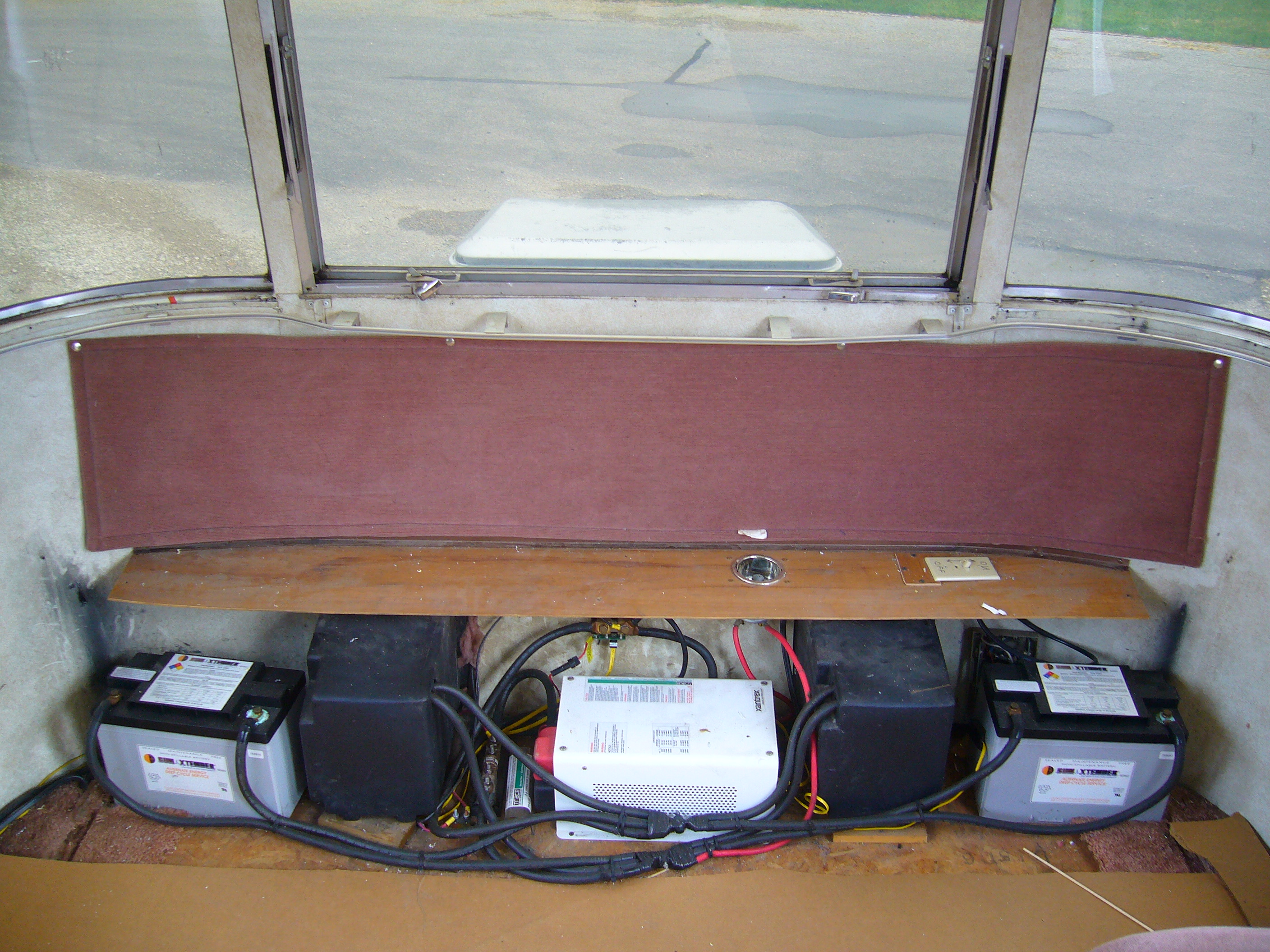

I did remove the under couch drawer and looking from inside out could see some daylight around the plastic box near the battery door. Sealed from inside and from outside at the little doors. Fixed. Other leak was skylight and leaked down to just forward of the entry door. New Maxum...all good. Anyway check the battery box. First noticed that leak after pulling up I 95 in very very heavy rain. Sealed everything g outside ...rivets etc and all is good.

But the bright white light especially near bottom corners was where I sealed and it worked. It is true, the plastic box is thin. I have taken all the carpet up from under the couch and chair storage area as well as living room/kitchen too so if there is another leak, I can easily see it. Laminate where it can be seen...just plywood where out of site.

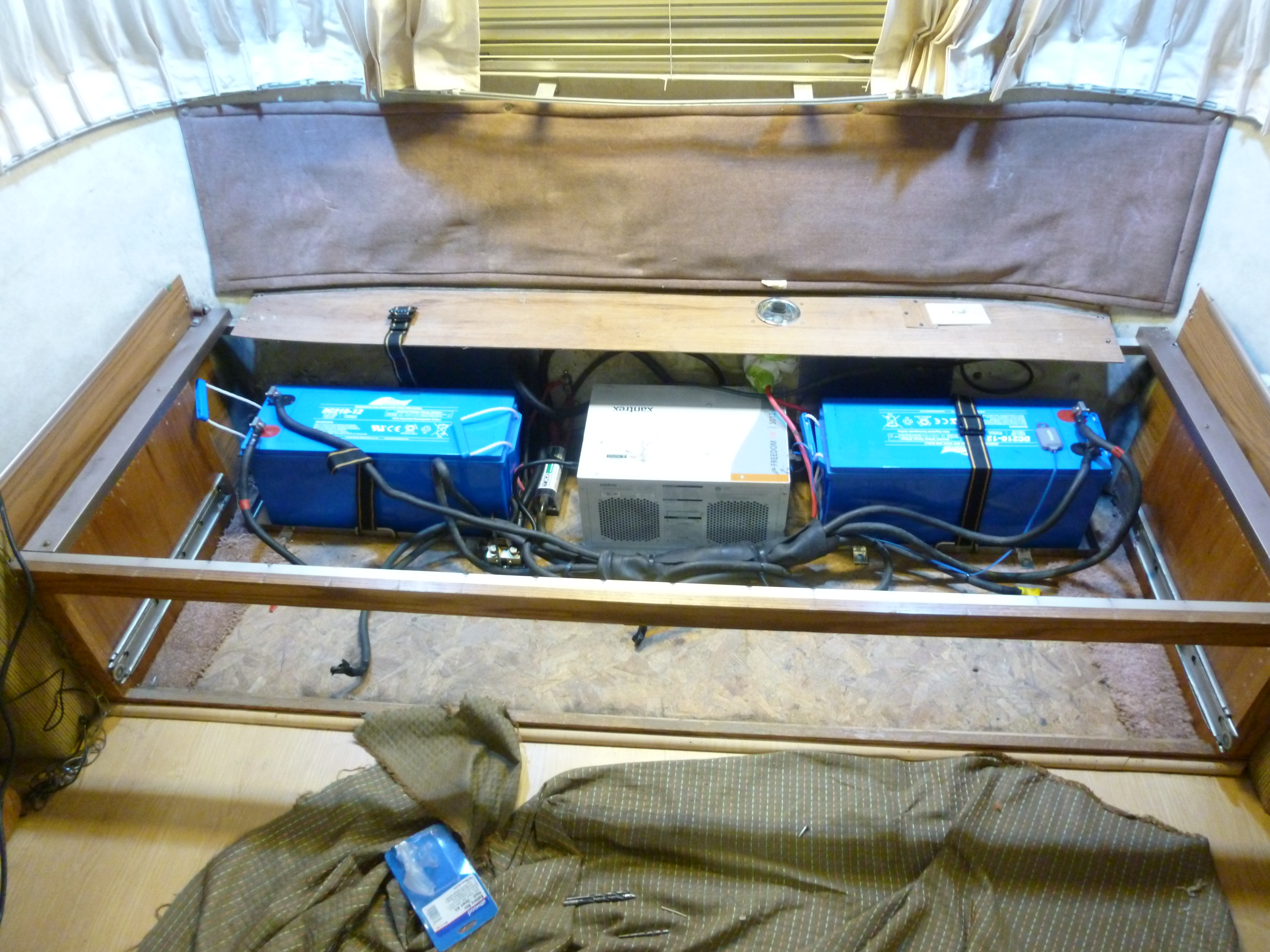

I had JC remove the battery boxes entirely. I provided them with stainless steel trays, which they screwed into the frame and strapped down the AGM batteries. Tey then replaced the plate (the front panel that goes from the window down to the frame) and they sealed up the area where the battery boxes were with insulation and aluminum. Works just fine. Here are the before and after photos:
