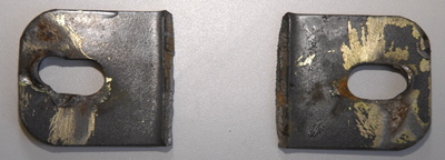

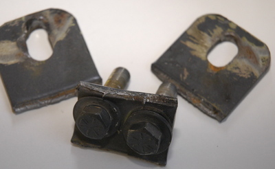

the part that broke is pictured here..
http://www.airforums.com/forums/302952-post89.html
and in the next post #90.
the 'greasin' issue is specific to the w/d bar heads where they insert into the main haha body...
shown in posts 91-95 above...
there may be other and several issues contributing to this/his specific part breaking..
but YES YES YES grease those bar heads!

Yes, 2air is, as usual, correct in his point: grease is good. The blog entry speaks for itself but I'll add a few things to further the conspiracy:
1) I've been using a mini grease gun, to keep the load of equipment in my bumper compartment to a minimum. But it takes 40-50 pumps of that silly little tool to fill the grease chambers every 500 miles, which is part of why I wasn't doing it as much as I should have initially. I'm switching to a "big boy" grease gun.
2) I have noticed (long ago in my misspent haha youth) that lack of frequent greasing can cause wierd tracking issues. GREASE GREASE GREASE as 2air rightly recommends.
3) I've already replaced my zerks twice due to having worn off the nubs and will be removing and replacing the current ones to check them as part of this repair. I carry a spare set because you can't just pick them up anywhere -- not a hardware store item. They do wear out in normal use, so expect it.
4) About 20 minutes before this failure, we crossed over a VERY rough train track. I was caught off guard by a severe bump at about 20 MPH and my wife who was following reported that the wheels of the trailer actually left the ground! This may have overstressed the bracket, leading to the failure only a few miles later. So I can't state the cause of this failure conclusively. It may be a complex set of issues.
5) Non- haha owners take note: this U-bracket and bar arrangement is used on other brands of hitches -- and I was told by a dealer that the bracket is a common failure point on those hitches as well. It's not an issue exclusive to Hensley.

OK, I replaced both U-brackets on my hitch and I advise other owners to go check theirs if they have a lot of miles.
See larger image at:
http://tour.airstreamlife.com/weblog...des%20rust.jpg
I talked to some more knowledgeable folks about this and they said that if the part failed due to metal fatigue, I'd see a rust line where the metal has been breaking for some time. In the photo above, you can see a clear rust line on both of the broken sides of the U-bracket, as well as sharp shiny steel where it finally broke.
You can also see severe stretching of the holes where the pin ties this U-bracket to the screw jack. This part needed replacement.
See larger image at
http://tour.airstreamlife.com/weblog...%20bracket.jpg
You can see the same metal fatigue rust line in the second photo, which shows the remains of the bottom part of the bracket. Also note distortion in the plate from the last bits of metal bending before they broke.
See larger image at http://tour.airstreamlife.com/weblog...%20bracket.jpg
The last photo (above) shows the other U-bracket. At first glance it appears OK. It's very hard to see in this photo, but the upper corner has a distinct crack in it. It was already in the process of failing! This crack is so subtle that you would not notice it in a casual inspection. You really have to look closely.
I will be replacing both U-brackets annually from now on.

oh yea baby!
i can definitely see the rust in your crack!
it appears this u-bracket is the same piece on the 1000 and 1400 lb bars...
with that much MORE stress on the heavier bar users...
so it may be that your gradually failing u bracket broke on the rr tracks,
then it took a few miles for the bar to work itself out and fall...
u r really lucky 4 no trailer, gas line or brake line damage...
excellent post!
cheers
2air'

Thank you very much for taking the time to post this information. I just purchased a haha in June, and will be keeping an eye on those U brackets. Do you have any idea how many miles were on those brackets before they broke?
Thanks again
