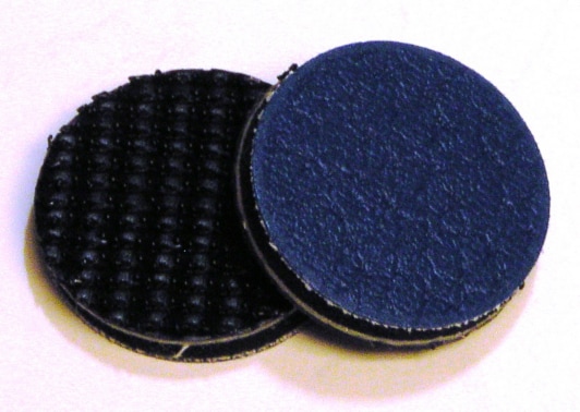

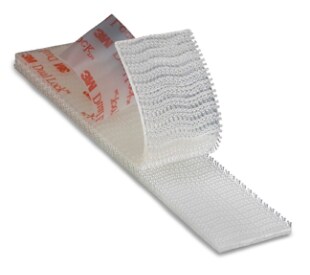

My latches are different in the 84 and I can find them cheaper than that but I got tired of them breaking so I replaced the broken ones with 3M dual lock tape
http://www.3m.com/3M/en_US/company-u...ual+lock&rt=rs
There are a bunch of different types and sizes, you want them to have enough force to keep the cabinet or drawer closed, but not to much to be difficult to open.
This is the type I used:
I have not tried these round ones yet, they may fit your needs.
