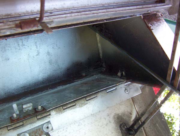

I have started the search for our leak. I need to get this done before I begin the much bigger task of working with the deteriorated OSB in the rear of our 2002 22' AS. Today it rained mightily and an area in the back under the sink that was almost dry is now wet again. I tried to examine carefully the rear area and can see no evidence of broken or seriously deteriorated caulk/sealant. Finally I began to wonder about the bumper. Should there be a good bead of sealant right where the lower band meets the bumper? It certainly gets wet there, but I don't know how that area is connected to the C-Channel and floor area.

Vulkem is on.
I called Airstream today. The rep confirmed that the seal in the bumper area is behind the rub rail, and "frequently" will work loose to allow water to seep in. He said that the rub rail is screwed on, but as I found out, it's really riveted on. Having no rivet gun (and never having used one). I decided to caulk the rub rail/bumper intersection. I purchased Vulkem 116 (Aluminum Stone tint) yesterday. I will let you be the judge on the color.
I hope now the water that collects on the bumper will run off to the side, rather than into the trailer. Once this sets and I get the inside dried out well, I will run a hose back there (or wait for rain) to see what happens.
One other clue of water seepage is from the sewage holding tank cover. I have an aluminum cover on the tank. After rains it drips water for sometimes a day or so. I first thought I had a leaking tank. In fact, water seeps in from the bumper to the holding tank cover, and may even "fill up" the holding tank cover.
This seems like an area that everyone should check when making sure their trailer is secure. I wish I had. Estimates for repairs now run as high as $6000.

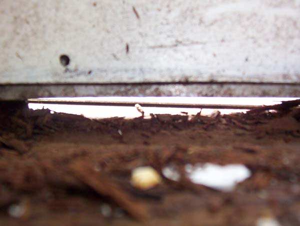

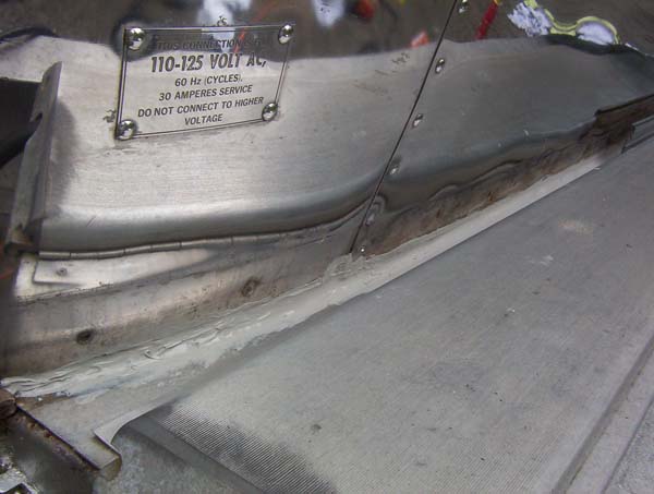

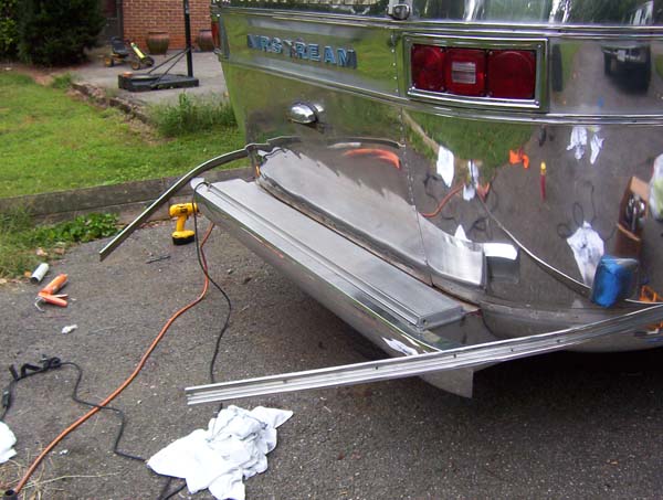

Old 10-03-2009, 09:14 PM   #8
Blog Entries: 52
Tanker,
From the looks of it, your trunk runs right up to the base of the trimline (just like our 1979). Our rear floor was rotted due to water running off the trunk into the flooring right behind the trimline track. You sealed the top of the trimline track but nothing will stop water from going over the trunk but under the trimline track straight into the end of the flooring (if AS didn't improve the design between 1979 and 2002). Riveting the trimline back on is fairly easy and you can get a rivet gun and aluminum rivets (the medium and long shank ones) from Lowe's or Home Depot (or similar place) for about $25 total. Our trimline track was in 2 pieces and met up right in the center of the rear so once we drilled out the rivets across the back, the trimline can be pulled back to see the trunk/wall meeting and allow you to use vulkem to seal off the gap.
Shot of the trimline track pulled of:
This was the inside of our floor looking to the outside when the track was removed. Our gap was huge.
This is where we sealed it with Vulkem:
We also found that there was an aluminum piece inside the trunk, near the top that let water between it and the frame which also went to the base of the flooring. We used the bathroom mirror to see it better since it is on the roof of the trunk space and sealed it of as well.
This shot is odd but it is of a mirror wedged into the trunk at an angle to see the top of the inside of the trunk. Notice the Vulkem bead around where the top of the frame meets the ceiling of the trunk which is aluminum sheet. We also continued the bead on the outside where the aluminum against frame would let water under it.
