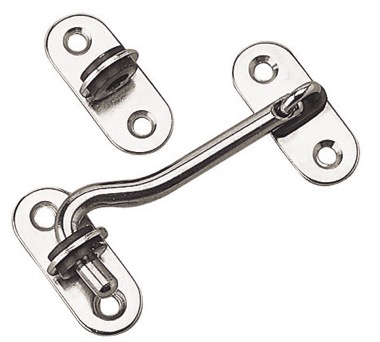

Here:
Sea-Dog : Quality Marine, Industrial and Rigging Hardware
One eye for the door, one eye to secure the hook when not deployed. Available in several lengths, up to 4".
West Marine and other marine suppliers stock or can order SeaDog stuff.
