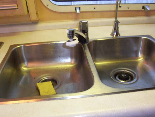

Cid,
We also reinstalled the original SS sink in our AS after reno. We used scotchbright with a quick once-over to get rid of the scratches and black marks and it did a decent job. I am sure we could have gotten some finer grade wool and gotten less swirling and a shinier finish but we were happy with the results for our use. We also have done this with our kitchen sink to freshen it up.
Before:
After:
