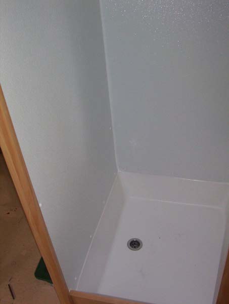

I decided to go away from the wood for the shower walls. I was worried about getting it sealed well enough in such a moist area. I ended up going a similar route as HappyCampers using a PVC shower board (1/4") from Home Depot as the barrier between walls and shower stall. I used screws with plastic grommet type things with caps to mount and 100% silicone to seal the PVC board.
Here are some photos of how it turned out:

Do you have any photos that show the top part of the new shower? Also, why did you feel you needed the plastic-covered screws? Did you not think that the glue would have enough holding power?

I used glue as well as the screws but because the wooden walls are floating paneling, only the cross-members can be glued and I was worried that traveling and shifting may cause the glue to pull away as well as steam/heat over time from shower. I am always going overboard with stuff like this though so maybe didn't need them.
As far as pictures of the top, this one was before putting the silcone sealer on (and that is a clear plastic bag in the basin):
Here is a close-up of the top after the sealer. I still need to put the mounts for a curtain rod.

Beautiful, just great! And, you answered my last question: you're going to put a shower curtain on the door. And I imagine that's a light fixture on the ceiling?

Yup. That was the light fixture in the shower when we got her. I just cleaned it up a bit. Not sure if it is original but it is bright and works great. Once I get a shower curtain and rod attached, I may put a board across the top of the entry into the shower, depending on whether it needs it for a finished look or not.
There was an aftermarket plastic light in the hall right outside that shower wall that broke when I tried to remove it. I am going to make a custom light using the insides of the broke one. Frame it in pine and get a translucent plastic sheet and cut for the "lens" or cover.
