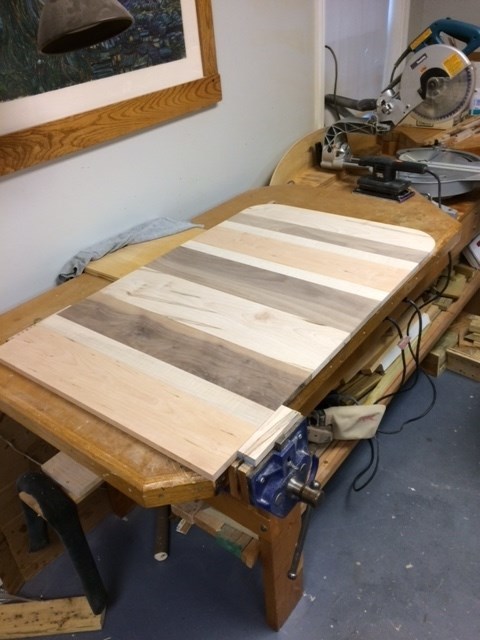

That's quoting my own question from post #24. I found that the only way to use real wood of normal thickness to support a bed is to run the boards sideways - like bed slats run. So I'm working on making a table that way:
That's ten maple, walnut, and cherry boards 26" long with a total width of 42". They are edge glued with biscuits to help keep the boards lined up while glueing. I have no doubt it'll hold up the bed, but frankly the center will sag if used as a table. I'll have to attach cleats or battens under the table to give it sufficient strength. So this is a work in process...
That's why if you look at the tables in your home they generally have about a 4" wide apron supporting the top. There's a reason why RV makers use particle board and formica - it's strong and light.

I think a table would be strongest if it had a set of boards under that glued up at 90 degrees to the top. That way, everything is locked together. It wouldn't need to the the total width, but close.
