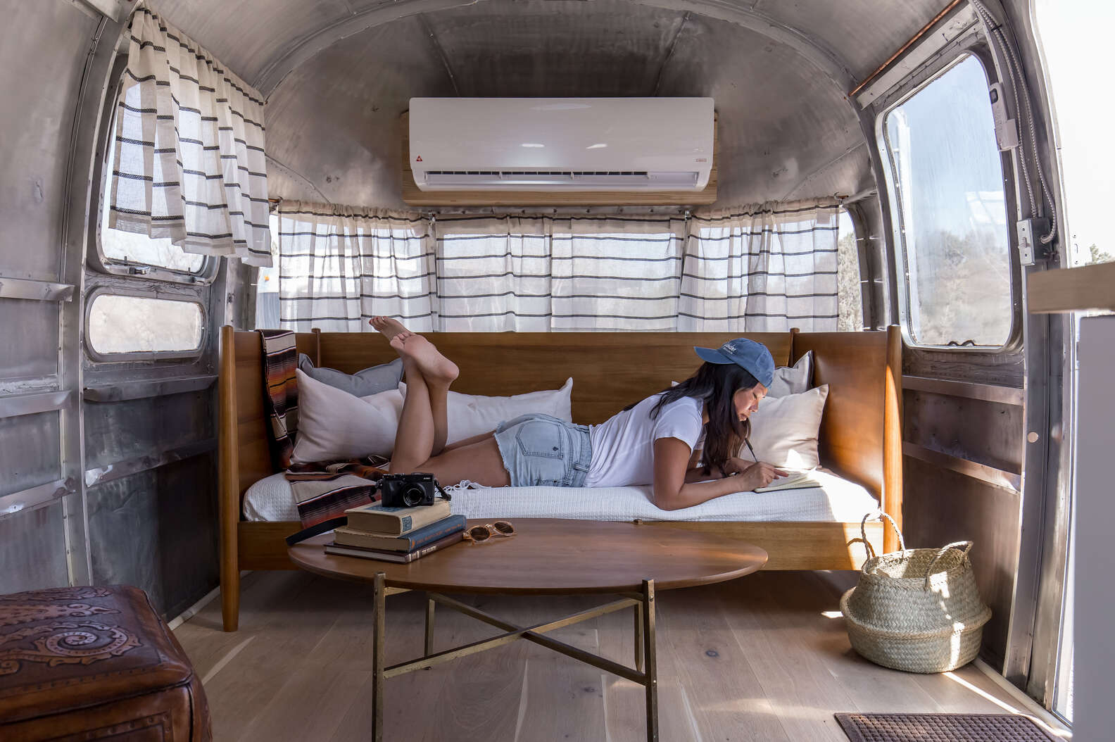

I would love to know more on how to install also. I found these photos of airstreams at Yonder Escalante of their Airstreams with the mini-split units. First photo - Looks like they mounted the outdoor part of the unit on the front trailer frame where the propane tanks sit. Looks like they had to cut a hole through to connect the indoor and outdoor parts.
Didn’t realize that RV destination existed in Utah. They were smart to install energy efficient minis. It is much simpler to install a mini split on a park model setup. Since we travel in our 55 with the condenser on the tongue, we placed rubber isolation feet. We also place an aluminum shroud over the condenser when traveling to protect the unit from road debris. And yes, you have to cut a small hole in the bottom of the AS for the line set to enter the interior of the AS and connect to the air handler.

Yes, right now I am leaning toward mounting it on the tongue of the trailer like the photo in previous post if not overly complicated. My reasoning for that is it would be easier to move the trailer if needed. Not really planning on moving it once it is there... but we all know things happen that we weren't planning and I would rather have an easy option for moving the trailer in the event that happens.
By making the trailer 100% electric and removing the propane tanks, that should allow space on the tongue to mount it. I need to look at the different size mini-split units to see what size would be best.
I'm guessing the interior space on my 34 is roughly 250sqft. A 1 ton mini-split unit says it will cover a 450 sqft space. I know Airstreams are not the most insulated so do you think a 1 ton unit is about right or overkill? Keep in mind, this will not be sitting in the full sun on a 90+ degree day. It will be shaded which should help lower the AC costs to cool it in summer.
