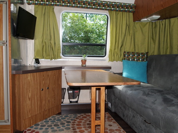

I removed the hideous fabric wall and cut a piece of Aluminum to fit.
You can kind of see it in this pic

Timmaah, wow, fantastic job! I really like what you have done, the interior looks great. I see you have replaced the countertops and placed new aluminum skins in places. About the skins, did you remove the existing wall treatment, or just mount the new skin over top of the existing? If you went over the top, I imagine you used Olympic rivets?

Counter tops I went right over the top. First replaced the rounded edges with a scrap square piece.
For the aluminum I removed the wooden wall panel in the kitchen and used it as a template. Same with the padded wall. The bathroom I just cut a piece to go over the old. No riveting.. all the edges are behind a piece of trim or cabinet or counter top so that holds it in really well.
The outside we used citristrip and polished with Gords Aluminum Polish. Both were crazy messy. Especially the gords. It needs another once over with the gords, but I'm not sure I have it in me.
We must have good luck. Amazingly all our windows work fine and don't leak. I did add another seal to the emergency exit portion of the back window that helped keep dust out.
