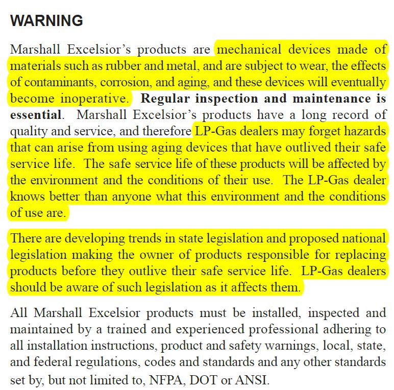

Someone on another forum claims to have found the elusive "must be replaced every 10 years" statement, not on any propane hoses (which in this context are custom-installed rather than mass-produced, and therefore don't come in packages upon which warnings could be printed) but, rather, on an RV propane regulator package.
I set about re-checking for the existence of such statements from any source. I reviewed Marshall's 39-page catalog and instruction manual (PDF here - Marshall aka MEC is a large RV supplier).
I found no *explicit* statements as to hard-and-fast replacement intervals on any propane product.
However, their materials do contain this general acknowledgment that their products have finite lifespans. Here is some squirmy wording aimed not at the consumers who might get blown up if they accidentally forget to change out their end-of-life propane equipment (for which nobody specified a lifespan to them), but is rather intended for the contractors who install Marshall products. But what about the majority of owners who never have a reason to visit propane equipment installers or contractors?
I am not aware of the legislation to which they elude as putting the onus on owners. Which leaves open the question of how owners are supposed to receive the information that they need to manage this issue safely.
