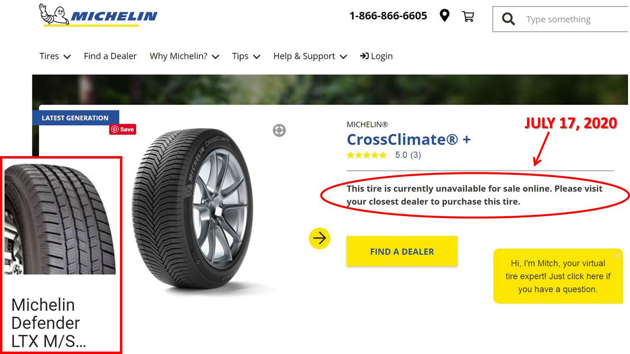

TL;DR from my concurrent tires thread -
If you think you will need tires soon due to differential wear, general wear, or age, you might want to get them sooner than later.
Major tire chains report that they are abnormally low on inventory because supply cannot keep up with demand during the pandemic. And their shortages are getting worse.
I tried to replace my spare tire yesterday only to discover that the tire most frequently referenced for the T1N Sprinter, the Michelin Defender LTX M/S, is sold out nation-wide. It's not an exotic or rare tire - it's a bread-and-butter product that is normally in stock within 10 miles of me. I was digging deep to find that one because it matches my other four.

I thought the Defender was discontinued by Michelin in the size necessary for the AI and replaced by the Agilis Crossclimate... Iím probably wrong about that, but the Defender was out of stock everywhere last year when I was searching for my replacement tires.
Very astute observation - you know tires well.
As was explained to me, Defender was not done away with exactly, but rather the name and/or model number of the Defender was changed. It's the same tire, but may appear as different, depending on the year. And if the old information is fed into the computer, it will say "discontinued".
Because I buy my tires in pairs, I have one pair of the older Defender and one pair of the newer Defender. My most recent pair was purchased a year ago tomorrow, at which time they were for sale in abundance.
The Crossclimate is my only decent alternative choice if I am not able to secure another Defender to go with the other four I already have.
However, the Crossclimate is a different tire. It has a completely different tread (images below). I don't want to mix the two.
Also, I've been told by sales reps that the Crossclimate's availability is also very limited right now. There are a few of them remaining in brick-and-mortars on the south side of Houston, but they are currently not available for order through some online sources, including the manufacturer.
Yesterday afternoon, I made the sales rep read back to me every spec of the Defender that he put on order for me from the Orlando Florida warehouse (that's where he found the closest Defender to me - I am in Houston Texas). I told him that if my order gets messed up and I don't receive the correct tire in 5 days when the shipment arrives here in Houston, then I have a bad situation, because I probably won't have time to try again to ship it from elsewhere. They need to get my order right the first time, in other words.
That Crossclimate+ tire in your image is not a truck tire. It is a car tire. The tire you want to replace your Defenders in the Agillis Crossclimate truck tire. You will notice in the link below that the tread pattern is the very similar to the Defender.
https://www.michelintruck.com/tires-...s-crossclimate
Good luck getting your Defender tire. But if you canít get it the Agillis Crossclimate is the tire you want to replace your Defender.

Originally Posted by Boxster1971 View Post
That Crossclimate+ tire in your image is not a truck tire. It is a car tire. ....
Thanks. That thought crossed my mind after I posted it - do you know how something might nag at you just below your conscious awareness... well, the pic stuck in my mind because the depth of the tire did not seem right. So I wondered if perhaps they put the name "Crossclimate" on multiple products.
Sure enough, they do that - I looked it up this morning. There is also a standard load Defender on the market, with quite different structure and tread obviously.
With 171,476 words in the English language, they need to name completely different products the same thing?! Why not have one name for each product? It would be like giving birth to triplets and naming them John 1, John 2, and John 3 instead of John, Bill, and Jack.
