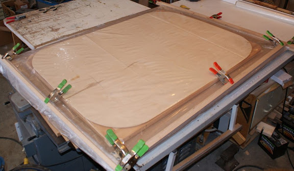

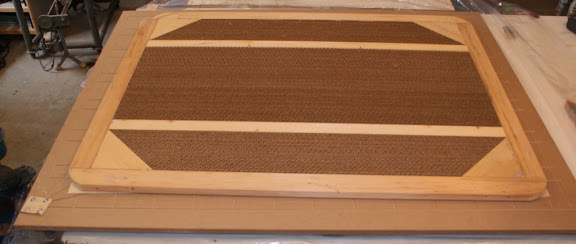

Table Pedestal
It's been hard to work on the trailer lately due to the weather, but we have had a few decent days and hardly any snow until the past week. I've insulated most of the interior with 1" Dow Super Tuff-R Polyisocyanurate Rigid Foam Insulated Sheathing from Lowes.
I wanted to start on the interior, but the only thing I could think of that didn't require measuring off the interior panels (which are still out) was the table. We're going to have a wrap-around dinette in the front to seat six. I'm figuring on the table being 48" by 53", and since it won't attach to a wall it will need a substantial pedestal to make it solid.
Using some scrap metal that I had I welded up a pedestal. Then I made a shell of 1/2" Baltic Birch plywood to cover it. While it will be hard to tell until it's all together and bolted to the trailer floor, it feels like it will be rock solid.

The table base looks great Grant. Any idea what it weighs?
Kevin
44 pounds

The first table I created was made of MDF. Too heavy, and as it turned out it was slightly too large, as I described in Post #33. I decided to use resin impregnated cardboard with a sheet of 1/8 Baltic Birch plywood on each side to make the table lighter and stronger.
Using an old milking machine vacuum pump from our farm
I built a vacuum form to glue up the pieces.
Here is the finished table:
