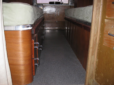

Mine is the dynamic 1-2 punch of my Seamstress and Custom Upholsterer-- aka my Mom and Dad. I took this picture a couple of months ago, when we were out shopping for fabrics for the twin beds. Since then, my Secret Weapon team has been extremely busy in my sweat shop... err, I mean... the upholstery supply house. You see, I've also had my Mom busy making baby curtains and blankets, too, but that's another blog post.

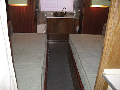

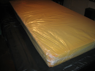

Just for reference, here's some before pictures of the twin beds as I received them:

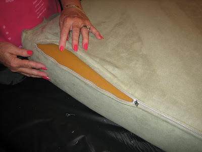

The 5" high density foam was in great shape, and very comfortable too. But the mattress covers were dingy and torn, and needed to be replaced.

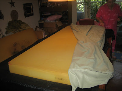

Since I had created curved beds, first I had to cut the corners of the foam. Then, my mom cut and sewed all of the fabric. I chose a soft celery color in microfiber, and an edge-welt piping in a grayish-purplish textured twill.
The microfiber is a hard-wearing upholstery fabric, but my Dad found that it gripped the foam really tightly as he slipped it on. So, he came up with the ingenuous idea of covering the foam in plastic to help it slide easier, using inexpensive drop cloths.
And, the cover slipped right on.
My Seamstress also thoughtfully included a zipper on each, so the covers can be removed and washed.
The final product:
They look amazing!
I also ordered my sweat shop... that is, upholstery supplier... to create two small bolsters to be used as back rests on the twin beds. They also have another purpose to be revealed at a later date. For this, I had to buy new foam, and my Dad carefully measured and marked, then cut it with an electric carving knife.
These are pretty much a reverse of the twin bed mattress covers, with the twill on the front and back, and the celery microfiber used for welting and the side-banding. More complete shots to come...
I can not thank my Mom and Dad enough-- you two have really delivered so far beyond my dreams, I love the cushions. Thanks!

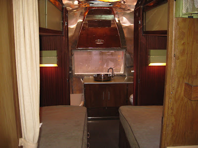

My folks weren't the only ones working in a sweat shop. During a conversation I had with some of my Airstream buddies, I decided that I'd been taking it too easy, luxuriating in the Airstream's A/C and not getting enough work done. Progress had been slow, and I had deadlines approaching.
So I turned off the A/C, opened up the Airstream, clicked on the Fantastic Fan, and went to work. I felt like Rocky, training in that old-skewl gym in Philly. And, it felt good!

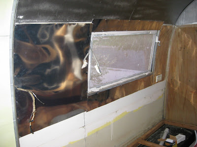

First, I cut some aluminum to trim out the bedroom walls.
Then I called up some Muscle to help me install aluminum panels on the bedroom ceiling. Several months back I had begin stripping the aluminum with the intent to polish, as I did for the bathroom lower panels, but ultimately decided it would be easier just to cover it with fresh new aluminum. So my brother Evan and my friend Greg, two characters seen before in this blog, took some time to come help me hang the aluminum.
I measured and cut, and then had to tape off and cut the openings for the light switch and light fixture:
My wife couldn't help but wonder if we were actually working, or just drinking beer, but she took the picture anyway:
The usual-- drill, cleco, and rivet. Only this time, it was all over our heads.
Yes, it can be pretty blinding in there. here's to you, Evan and Greg-- thanks for the help!

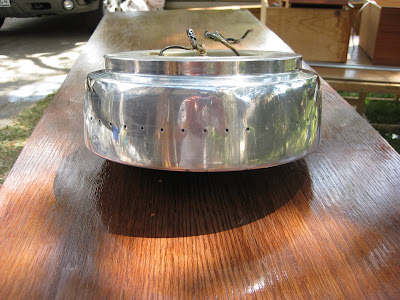

With the ceiling panel finally in, it was time to decide what to do about lighting. I had considered installing some recessed 12V lights along each side of the bedroom, but then I discovered something, or rather, remembered something I once knew a while back. I was thinking about repainting my light fixture, which looked like this when I received the trailer:
I began to sand off the heavy latex house paint that had been painted onto it, and something shiny began to peer through. That's when I remembered these fixtures were made of aluminum. Out came my old Citristrip, but that only got the job half-done. The latex house paint came off, but the original, thin, baked-on enamel coating was holding firm in several places. On Frank's recommendation, I picked up a quart of Aircraft Remover, and within 30 second the tough enamel was melting away. After some MEK to clean the residue, the end result:
In bare metal, I absolutely love this fixture. It looks so "Jetsons!"

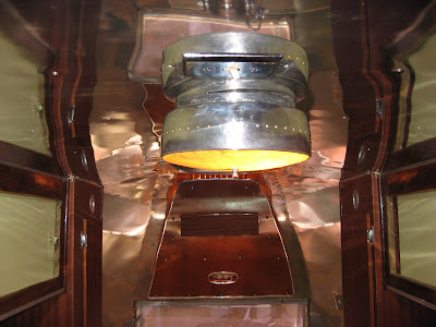

so, with the new aluminum ceiling in, and my lighting solution determined, I began putting the furniture back in. As I said, I was working with no A/C, and decided that taking breaks for pictures was not productive. So, here is the way she currently sits:

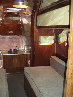

Full view straight down the main aisle, the lighting fixtures and overhead doors are painted a soft green to complement the celery cushions.
The gray twill bolsters in place, and behind them, the wall is lined with a padded "headboard" of faux ostrich leather.
Above, the original oak cabinets have been refinished in mahogany stain.
The "Jetsons" lighting fixture in place.
Two-tone green lighting fixture above the bed.
You've seen this shot before, now the wardrobe wall is painted out in white marine urethane paint.

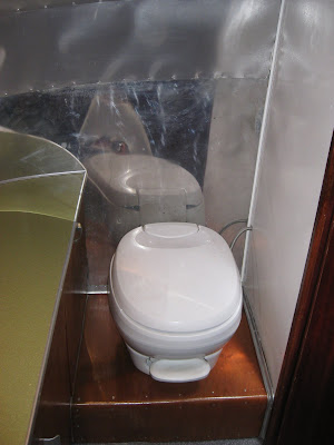

The shower wall is also painted in the white marine paint, and the shower mixer has been moved from the side of the vanity, to the wardrobe wall. I have yet to install the tub trim to cover the edge where the tub is riveted to the wall, and to help channel water off the wall and into the tub.
But with the move of the mixer to the wardrobe wall instead of the vanity, now the shower head can be placed at full height to take a standing shower, rather than about half that height on the curved dome, as it previously was.
A shot back toward the front end. Man, that galley and lounge area need a makeover now!
There's still some trim work, and one other major feature on the beds yet to install. More updates coming soon! Hope you enjoyed the pictures!

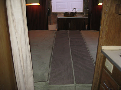

What do you do when a functional requirement seems to mess up the clean lines of your design? Well, whatever you do, it looks better in rich mahogany.
When we first got our Airstream, Catarina, a year ago, my wife Mary lamented that we couldn't sleep side by side. The only beds were the twins. Eventually I plan to create a front dinette that converts into a queen-sized bed, but until then, the only beds in the Airstream are the twins. Mary wondered if there were a way to fill the gap between the beds, down the aisle, and make one big bed out of it. When she uttered that thought, the idea of "Superbed" was born, and has been percolating in my brain ever since.
We won't always deploy Superbed, but right now, since our children are still small and in diapers, we won't be blocking the aisle if we do decide to use Superbed. We've also been couped up in the Airstream through several thundershowers on our various camping trips so far, and I can imagine a time when we might want our whole family to be able to snuggle up on Superbed and watch movies whilst waiting out a storm.
So I developed the idea of using two long cleats down the side of each twin bed, to support a plywood platform, where a couple of bolster cushions could be moved in to cover the center of the bed, and make the entire thing into Superbed. This is actually quite similar to the design of many dinettes, I simply applied it to the twins. The main problem with the cleats, for me, was an aesthetic one. I loved the clean lines of the curved beds. But, the cleats were necessary, so I bought a nice piece of solid mahogany, and ripped it down into a couple of 3/4" thick cleats that run the length of each bed.
But before installing them, I had to finish some trim work on the beds. This photo also shows the drawer hardware I used, matching the hardware on the the vanity.
Right below the metal trim, in the photo above, you can see the mahogany cleat. Another shot, showing both twins:
The bedroom as it normally sits:
And now, with Superbed deployed:
See-- I told you those square bolsters had another purpose!
Just a bit more trim work, installation of the curtains, and she will be done. For the time being, anyway...
