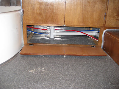

Finishing up work on the vanity right now. It still needed its bottom fold-out door, and the bottom to the upper cabinet. So here is the new lower door, with the original closing hardware.
Man I need to vacuum in there. And here it is with the door open.
This gives me some limited access to plumbing supply lines and drain lines. I can also place some shallow bins down here, with spare plumbing bits and other bathroom-related items.
But I wanted better access, so the shelves that form the bottom of the upper storage cabinet just slide in and rest on tabs all the way around. They can be removed via the finger-holes.
I slotted the one on the left, so it can be pulled in and out, while still allowing room for the drain line.
I also installed the door pulls, but my camera battery died before I could get pictures of that, so you fine folks will just have to wait until next time.

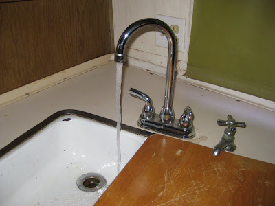

Pictures As Promises, And Plumbing Too

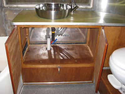

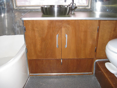

Last post I mentioned the vanity door pulls were attached, here's a shot of them on the vanity. They are very simple and modern, I love them.
Here's a shot to show the interior shelves removed, with access all the way to the floor:

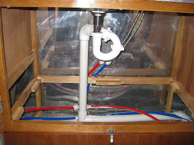

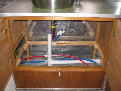

I've also been working on the plumbing, and I'm happy to say that, aside from some minor work on hose routing and some assorted tie-downs, the entire trailer is completely plumbed, both fresh water and drains.
Galley sink from below:

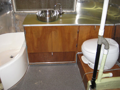

And, much like the picture of a person standing on the ground while inside their trailer, I think another classic renovation shot is the first time water is running after a long absence-- in my case, about 8 months:
Here's the vanity from below.
I liked the idea of using the red and blue PEX to indicate hot and cold lines, but didn't want to buy TWO 50'coils just to get two colors, knowing the entire trailer re-plumb would use significantly less than 50'. So, I bought one 50' coil of white PEX, and used some very inexpensive red and blue electrical tape to mark the different colors. I saved myself over $20, and I only have 20 feet of extra PEX lying around, instead of 70 feet or so...
I had to get creative with a loop for the p-trap on the vanity sink, as my drain line from below (which I ran several months ago) was very close to the drain outlet on the sink.
And, of course, with water running:
I spoke a BIT prematurely saying all of the plumbing was "done" as the tub plumbing can't be completed until the wardrobe is in place. Originally, the tub/shower mixer was located on the side of the vanity, but I wanted to be able to place the shower head at the highest point, rather than along the curve of the rear dome, so I moved the plumbing to the wardrobe wall. Once the wardrobe is in place, the faucet/mixer will poke through the tall wardrobe wall, and there will be a low hook for filling the tub, and a high hook for taking a shower.
And, with the running water:
Yes, perhaps most importantly, this works, too:

Marcus, wonderful. I'm a great believed in access to utilities and much annoyed Airstream doesn't provide access in a lot of places. A lot of time it would cost very little for them to have removable panels, but they don't do it. I think you should have bought the red and blue pex since you'll be getting a lot of requests to restore other people's trailers.

I like the one roll of PEX idea, I think I'll borrow the idea and maybe use red and blue zip ties every few feet. (assuming PEX isn't a museum piece by the time I'm ready for plumbing!). Looking good....

I was even cheaper than you, Marcus. I just used a Red "Sharpie" on the hot water side. What can I say? "Cheep, Cheep"!
Not nearly as clean looking as your job, tho. Keep up the great work!

I was even cheaper and used the cylindrical slotted foam wrap pieces for the hot water run all the way from the water heater. Gotta be able to have a really hot shower now and then.

I was thinking about using the foam wrap pieces (which of course would render my red electrical tape job a complete waste of time ).
Does that insulation seem to make a large difference? I defer to experts like you, since although I have spent a year renovating this beautiful chunk of metal, I have actually only camped in it (or any RV for that matter) a grand total of three times, and only twice with running water...

I can tell you that the water coming out of the shower nozzle is very hot, almost to hot. I applied the foam wrap before I used the trailer so I can't compare. I do know that the wrap also helps keep the PEX plumbing lines from vibrating because of the pump. About every 10" or so, I used a cinch tie to keep the wrap on tight. I elected to not used the peel off adhesive in case I needed to take it back off.
Can't say I'm an expert, just someone who got there before you.

Thanks Brad, I think I'm going to go ahead and try it out. I also like your idea of not using the built-in adhehesive, to make it easier to remove if necessary. A few tie-wraps here and there should keep it secure enough.
