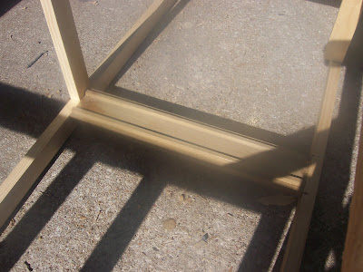

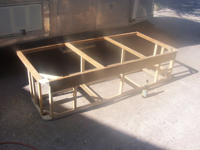

I've been working on other projects this week, but did manage to get some time in on the curbside twin. I told a couple of people that I'd include some more detailed shots, so here they are.
The curbside twin is the one with all of the drawers, so it is a bit more complex in construction. When I rounded the corners, I lost about six inches off the front surface, so the drawers had to be pinched in. I accomplished this by turning the 1x2 framing members 90 degrees from their original orientation. From above, you can see that the top of the front, and the top of the sides and back, are the only original framing members I retained. The rest is all new.
I also decided to change the layout. Originally the four small drawers were in a 2x2 grid at the fore end of the bed, and the two large drawers were one after another aftward. I decided to make it symmetrical, with two small drawers, then the two large drawers in the middle, and the two final small drawers at the back.
Below is some detail on the rounded corners. I took a piece of good 3/4" plywood and cut it into 3" x 3" squares. Then I clamped two pieces together at a time, used a compass to trace out a 3" arc on them, and cut with the jigsaw. I then used pocket holes through the straight wooden pieces around it, and drove the screws into the flat parts of the curved pieces. Before I fasten on the bending plywood outer skin, I'll use a belt sander to smooth it out and make it completely even with the framing timber around it. Also, I used angled pieces to provide extra support to the joint.
Here's a shot of the bottom curve and support:
After it's all glued and screwed together, it is incredibly sturdy. One thing I've noticed is that the factory used only mechanical fasteners and no glue. I am using both in order to make the joints very strong.
Another part I re-used is the drawer slides. They worked well and lasted for 46 years, so I don't see any reason to change them. I'll be re-using the drawers as well, with new veneers, and a thorough cleaning of course.
And here it is with a test-fit of some of the drawers. I will need to shave about 1/8" off the sides of each drawer front so they will all fit after the "shrinking" I did with the front, due to the curves.
Next I will skin it with the 1/8" bending birch, and put on 3-4 coats of polyurethane. The drawer fronts will be re-veneered, and new hardware will be added. Then, it will be time to move on to the next project.
