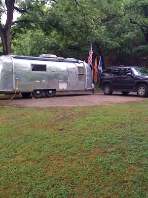

Where, of course, it rained all day Saturday. That's okay-- a canopy, some dice, and beers, were all we needed.
But the Airstream still looked great:
We still had a great time, as we always do. Many thanks to Dave and BG for taking care of all of the campsite details!

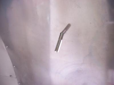

I don't have a metal brake, so all of the bending was done with a makeshift brake I fashioned from a vice, some clamps, and a couple of pieces of wood. It wasn't horrible, but I just couldn't live with it. So, I took it down, started over, and this is what I came up with:
I think it looks much nicer in ribbon-striped African mahogany. I also installed an aluminum side plate and mounted the switch there.
I know these aren't very good pictures, but once it's installed I'll take some better ones and it will make more sense in the overall design.

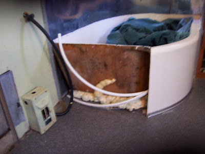

The foam under the bathtub also acts as an insulator so the water stays hotter. When I've installed new tubs at 2 houses, I place fiberglass in bags around the tub to insulate, but never thought of foam for leveling. It's a good idea and if I do another bathtub, I'll use that too.

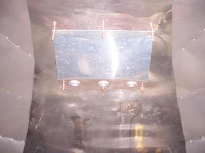

Some may remember that I mentioned some more twists I had planned-- well now the time has come to reveal one of them.
I've heard from a couple of people that the all-metal bathroom seemed a bit cold and sterile. I thought so too, but I always had a plan to warm it up a bit. The wood of the vanity helped, but there was one more piece I wanted to install to help it out. I really liked the way that Carlos Ferguson's metal heat shield looked against his wooden walls, and thought that the reverse might look cool as well. Of course, his was functional, while mine is purely decoration.
After making this piece from bendy birch, in my mind I began calling it "the sail" which I suppose is only appropriate for a Land Yacht.

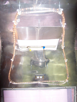

There's still a little trimming and fitting to do, but it's almost there. The piece is made from 1/8" bendy birch, edged with automotive door trim molding, and then held onto the ceiling with 19 standoffs. The standoffs are made up of 1/4" bolts that were installed through the aluminum panel before it was riveted to the interior endcap.
Over the bolts, are 1"-long sections of 1/2" PVC and fender washers on the backside, and then the sail, which was topped with nut caps on the front side. It sits a little over an inch off the ceiling.

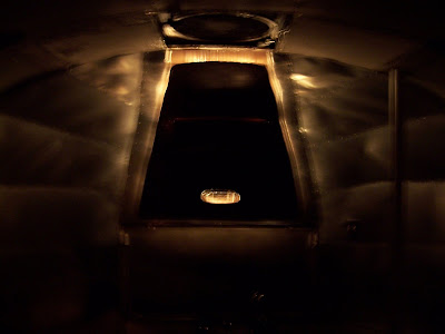

I shouldn't say the sail is entirely decorative, it does have some function, as it hides a 12' section of rope lights that sits behind it.
The rope light provides a nice, soft back-lighting behind the sail.

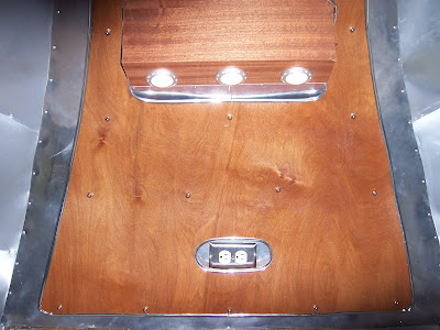

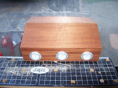

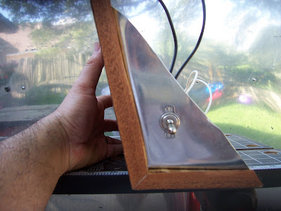

And the fixture I built from the African mahogany provides the direct down-lighting in the bathroom.
Overall, I think it's a really nice effect, warming up all of that metal.

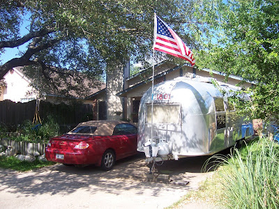

Happy Fourth of July!
Wishing everyone a happy and safe Fourth of July. I hope everyone has a great day, and I also hope everyone takes a few moments to remember what this holiday means to our country, to remember those who have fought and died so that we can live with the Freedoms and Liberties that we now enjoy. I'd like to say a special thank-you to all of you who currently serve, or have served, in our nation's armed forces.

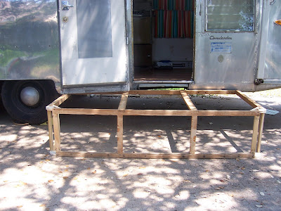

So, what have I been doing on the Airstream you might wonder? Well, I've been working on a new front door step, the old one seemed a bit small:

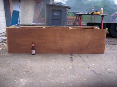

Ha! No, that's not really a door step. It's the frame for the street-side twin bed. The existing frame was in decent condition, so I just repaired one small weakness that had developed over the years, and then I cut out the front corners-- the ones that intrude into and define the walkway through the bedroom area-- and made them rounded. I was inspired to do this by the amazing work done by JP here on the AirForums.
After the frame was built out, I wrapped the bendy birch around the frame with lots of glue and some staples where you won't see them. Then a coat of stain to match the woodwork of the vanity and Sail in the bathroom.
Next I'll put on a few coats of poly, and move on to the street-side twin. That one will be much more difficult, since it has all of the drawers in it.

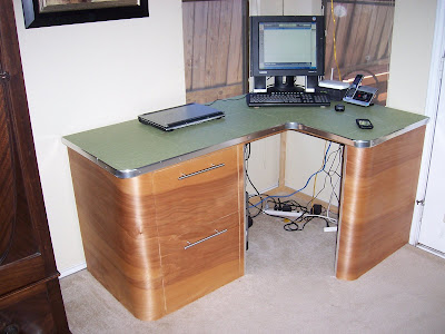

For those who don't know, my wife and I are expecting our second child in early September. This means the office becomes the nursery, and we had to make room for a small office in our living room. None of the desk/storage solutions on the market worked for our space and storage needs, so that means I had to custom-build a desk.
I decided that I could use this opportunity to practice for the Airstream furniture build-out and use the same construction techniques I intended to use on the twin beds (and, eventually, the galley furniture). I actually built the desk carcasses before the beds, but posted in reverse order since I didn't take any construction photos of the desk. But, here are some pictures of the finished product:
I think it turned out pretty nicely.

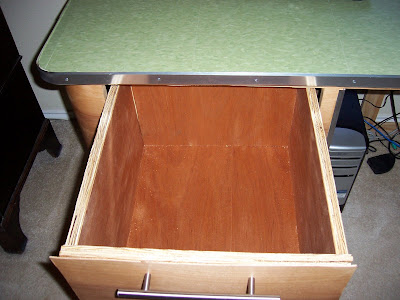

The desk top is made from Armstrong VCT tiles over 3/4" plywood, the kind of vinyl tiles you find in schools and hospitals and major industrial sites (same stuff I used for the top-flooring in the Airstream, just in a different color). This will be a great surface since it is nearly indestructible, and I have no doubt my near-two-year-old will have all sorts of ideas of how to treat it harshly.
The edge trim is fashioned from inexpensive aluminum commercial flooring "saddle" pieces. The pulls were leftover from another project, purchased at Ikea.
There is still some final trim work to do to cover up a few raw plywood edges with edge banding, but the functional parts are all complete, so now we can start clearing out the office and moving itin to this desk. The bottom drawer is a pull-out shelf for the printer/scanner.

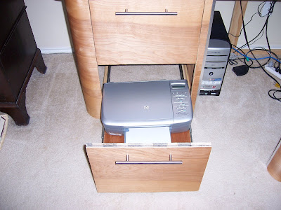

I didn't have time to trim the raw plywood edges, but I did take the time to line the shelf and drawer with mahogany veneer.
The top drawer is just a very deep drawer. I could set it up for file-folders, or use some organizing inserts so that it can hold paper, envelopes, stamps, pens, etc.
I enjoyed the work, and it really helped me prep for the AS projects that came afterward.
