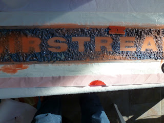

This is ONE pass with a razor. Okay 4 passes in a row LOL but all eight layers AND zolotone are virtually gone. This is epic!
The process after I refined it a little (of course I did
Paint a fairly thick layer of Citrastrip over the whole panel. Leave at least 4 hours (overnight was fine but I didn't find it worked any better and it was worse if it dried out).
Scrape a small one foot by one foot section using the plastic razor blade.
While the residue is still soft keep scraping until nothing else comes up
Using a cloth and some mineral spirits (or a little extra citrastrip), clean off any remaining paint in that one foot square section - really important to do this before the area dries out.
Move on!
I did this whole panel - the picture only shows half of it - in just over an hour. Then I pressure washed it and came back at it with a green 3m scrubby and some extra Citrastrip to get all the edges and areas I had missed.
