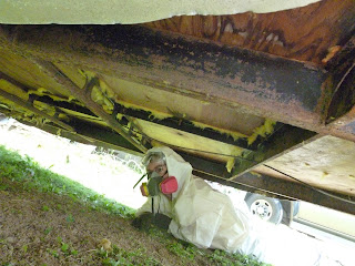

Well today was the day! Time to find out how bad the frame is.... and banish the bellypan.
If you have read my previous posts you know that I'm "not fond" of pink insulation. I look at the stuff, I itch.... to touch it .... shudder...... I'd rather babysit Sarah Palins children than touch insulation. Seriously, I don't know if its the formaldehyde in it or what, but I can't be around it.
My husband of course thinks this is just an excuse to get out of detaching the bellypan! Good thing he married me for better or worse cause this counts for the latter. When we got this Overlander the one thing he said is "I don't mind paying the bills for paying someone to do something you can't... but I REALLY don't want to spend my weekends working on the trailer"
Guess what he did this weekend?
And he has never looked sexier to me, Yep, love a man who can get his hands dirty !
It actually went surprisingly well (for me anyway!) Probably five hours from beginning to end, including cleaning up and a lunch break.
We used one of these bad boys - an 18 gauge electric sheet metal shears from Harbor Freight Tools. Getting them at the right angle to cut smoothly took some adjusting... but when they worked, they worked like "Butta" I'm channeling Paula Dean here, LOL
We had to cut a little lower on the belly pan because otherwise we kept running into the outriggers that were too tight to the belly pan to get the shears to fit. So after we were done, we went back and trimmed a little higher.
Wow, I keep saying "we" which is totally inaccurate, my DH did it all! And much of it flat on his back with the shears inches away from his face! Did I mention how sexy he looked??? Tyvek suit, goggles and gloves, it's a classic look! The electric shears were soooo worth it, I think I picked them up on a 40 percent off the $40 price. My sister and her husband did their Tradewind with hand shears and while it can be done, I'm sure it wasn't a rockin' good time! I sure love learning from their experiences (sorry sis!).
Now everyone says how disgusting the belly pan debris is but ....well.... I'll let you judge
Personally I've seen worse in my kids laundry baskets!!!! Just kidding, but there were no unidentifiable bodies, no skeletons, no smell, no more shotgun shells (exactly how does one dispose of live ammo anyway? It's not as if I can toss it in the trash...?).
There was no real treasure either but hey does a frame that's in pretty good shape count??? You BET! I'll wait for Colin's final assessment but I thought it looked pretty good?

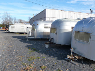

Colin recently moved to a new shop and he definitely has upgraded his digs! His front door is particularly impressive!!!
Nice and shiny! Wonder if that was polished by his secret recipe? LOL
Not only does he have heaters..... he has a parts room, a wood working shop and a shower!!! Living the life of luxury!
Some pictures of the shop...
To the right are Colin's two gantrys that he uses to lift of the trailer body. Nice setup.
His parking lot has some nice Airstreams! I'm kicking myself because I didn't get any pictures of Colin's '57 Sovereign... no wait ....that would be "'57 SOVEREIGN OF THE ROAD" emphasis added of course. !
Seriously, sweet sweet trailer.
