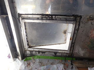

Before this last set of storms we actually had a few nice days where I actually got a few things done.
First was drilling out all the rivet remnants. When I initially removed the skin I just drilled the head and snapped it off. I thought that it was fast and efficient (it was!) but I didn't factor in the time needed to remove these remainders!
Ah well, good thing I recently discovered Pandora Radio. It's a cool app that you can type in an artist or song/genre and it creates a station with similar music. Pretty cool.
Next was stripping the refrigerator access doors. These had tons of paint and goo. The keys, alas, are long gone so I'll be replacing them with new ones from VTS.
First time this door has been open in a really really long time . Probably Carter was President!
Something serendipitous happened though! As I was slathering on the Citrastrip, I was eyeing the black residue on the skins. Now I have previously tried physically removing it by scraping and used nasty chemicals like adhesive remover. Nothing budged it. I wonder......
Along the lines of "well, it won't hurt" I gave it a quick swab with the brush. The stuff started to dissolve in SECONDS, nanoseconds even!!!! I little scrub with a 3m green scrubby and a swipe with some paper towels and it was gone! Yippee!
I did a couple of panels, but even though Citrastrip is pretty friendly, the fumes were getting toxic in an enclosed trailer. I'll do more removal when I can crank the windows open and run a fan.
I know some of you are probably thinking I'm nuttier than a squirrel turd for even bothering, but I'm planning on sealing everything with Tempro from the inside and I'd rather give it a good surface to adhere to! Yes, I'm planning on sealing each and every rivet.....
I'm really excited though. I thought it was going to take a bipartisan act of Congress to get that stuff off!
And I have plenty to go!
