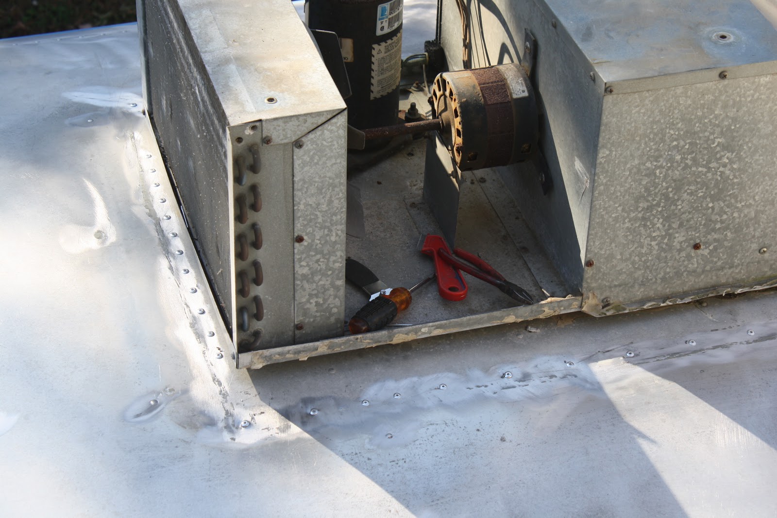

I also noticed lots of dabs of silicone all around the base of the now exposed AC unit. This AC is not original to the camper but is about 20 years old nonetheless. Turns out they were all previous drilled holes and had been sealed up with a dab of silicone on each one. Rather than rely on a caulk or this new coating to do all the work, I ended up drilling out each a bit and put a 3/16 pop rivet in each one. Pop rivets are fairly tight little buggers and should seal out any water with the new coating on top.

While I was removing the AC cover, I leaned against it a bit too hard and the plastic easily cracked. It actually cracked a bit more as I tried tried to get it off. To add insult to injury, I poked a bit at a spot on the evaporator fins and they crumbled to little bits. Something tells me we may be putting in a new AC unit in the near future, though this one still works.
