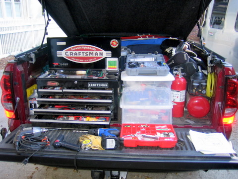

AirsDream, you really need some kinda interactive weight sensing -- sort of a rock sensor. Or just put a lock on the bed cover. The trailer is hers, the truck is mine. She has all the pretty interior spaces, I have the cool stuff in the truck bed. Not a bad trade-off for me.
[IMG]file:///C:/Users/dreamstreamr/My%20Pictures/Picasa%20Exports/2005%20CCD%2025%20tech%20pics/IMG_2493.jpg[/IMG]
Another solution, if there's the right amount of stuff in the truck's bed then there's no room for 800 pound rocks. Or you might find a big rock and be wondering, where's the big toolchest used to be right here???
