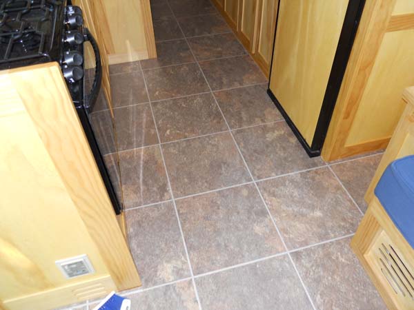

I have seen some posts where people have used trim and the ones I have seen use a glue of some sort and attach it to the walls (not the flooring). Some used quarter round, others have used the rubber trim like office buildings have which is more flexible for the curves. We didn't leave a gap at all on ours because I didn't want to have to trim it out (I know we probably should have). I figure it it starts to buckle, I could trim later. No buckling or gaps yet in over a year. The only issue we have is we do get some squeaks walking close to cabinets where it rubs slightly but I can live with that.
@reinergirl - I agree as well on flooring after cabinets. We used a floating floor and I want to be able to replace it easily if needed and also pull it up if we find leaks. We also coated the under floor on top with epoxy to seal it off.
Here is a shot after epoxy:
Here is one with the flooring down:
I doubt if you will ever have a buckle especially from side to side. You are only dealing with 88" at the most. I imaging the 1/4" suggested edge gap is taking into consideration floor runs of 50-60'
Your floor looks great.

Thanks! That was my thinking as well. We ran the panels (3 tiles across made a panel) width-wise. At the widest spot, there are only 1 and 2/3 panel across.

We used an epoxy called Tile Clad (1 gallon part A and 1 set gallon B which did 2 coats) from Sherman Williams. They can color it as well so we went with a tan color. I only shows under the bed storage and base of cabinets. It covers really well and dries creating a hard shell which will not let water penetrate.
