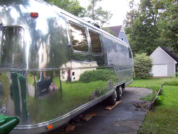

Our 1979 has sealed frames on all the windows. We have broken out the 4 vista view windows with success and they look great. Our front curved windows have the same tint issue and one is holding water (about an inch deep) and sweating between the panes. Neither are leaking to the inside currently but we have the front of the camper empty and the plastic frames off these windows so if there is a good time to fix, now is it.
Has anyone broken out the inside pane of these windows and res-sealed the outside pane? If so, I have enough of the Vista View replacement gasket from Can-Am to put around these windows once it is broken out, just not sure if it will fit (the gap looks smaller between the panes).
Below is he best picture I have of the window. It is the one at the top, right in this photo (and the opposite not shown):

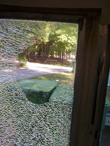

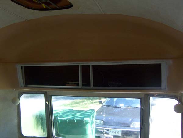

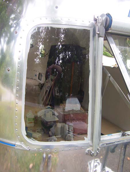

Thanks for the reply. Sorry to have gone against your post but I broke out the inside panes 2 days ago. Both windows had all kinds of junk in the panes and I knew I had to do something for a view out of them. I had your number ready to order replacement windows had something gone wrong.
I will say that since it is safety glass, it goes with a POP like a shotgun going off! I used a dremel with rotory blade to cut through the inside pane and as soon as the cutting blade goes through the pane, it shatters. It had the same groove size left with the inside pane gone as the Vista View windows and, once all the little glass pieces are pulled out, I used the same process. Also, we don't have a rockgaurd on ours, only the front awning. I also don't see any holes where one would have been mounted.
Before:
After the shatter (after which, I promptly went around to the outside to make sure the other pane hadn't broke):
After picking out some of the pieces:
After the whole process and with the Vulkem the oozed out of the outside cleaned up:
Here is the other wing window without the Vulkem cleaned yet:
With the outside window firmly seated in Vulkem against the outside frame, I don't expect a leak. We had a medium rain today and all was well.
