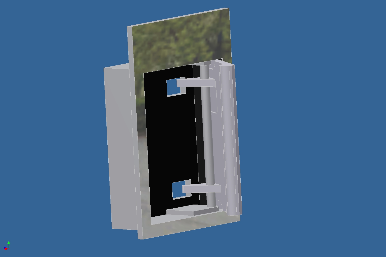

Here is an animation of the above.
motorcycleproducts.org/AS-Temp/81-ExcellaII-31ft/Door-Latch/Keeler-door-lock-movie.wmv
Perry
perryg114 is online now   Reply With Quote
http://www.motorcycleproducts.org/AS...lock-movie.wmv
Perry
