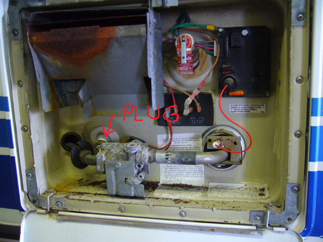

Hi Allen, it's a good idea to have the daler do it the first time and watch to learn what he does. Meanwhile, here are the 2 photos that show the drain cock and where it is installed.
Note that before you start, there will be a round plastic/nylon white plug. This is removed, the brass plug with the threaded hole in the middle for the drain cock replaces this. Make sure that you use teflon plumbing tape to ensure a good seal.
I've had this on my AS for a couple of years, and before that I had the same setup for over 10 years on an old Shasta trailer.

Hi Howard
Thanks for the photographs. Ths Airstream factory was not able to figue out how to proceed even after 2 calls. I purchased an electric jig saw. I think I may cut out a square area on the floor of my closet and this will allow access to the pump. I will replace the board with only a few screws for easy access next year.I will use a cedar board and while I am at it i will use cedar on all sides of the closet. I thought it would be worth a try as I think with your help and the Forum I understand the wintering procedure quite well. I would be done by now if the darn pump was accessable.
