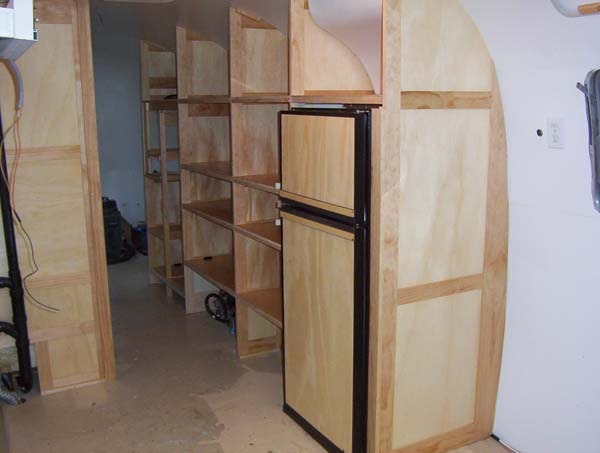

I did the same as Jim. I removed the panel in ours and used 1/8 pine plywood with a clear stain to match the what the rest of the interior will be eventually.
Tadd, Beth and Grundgetta
