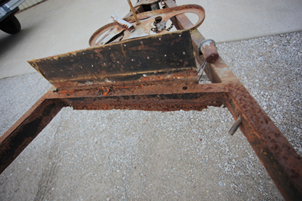

My father-in-law owns and RV conversion business (they turn horse trailers into living quarters and horse trailers) so he is checking on the price of a new frame. All is not lost on the old frame, however. As we pulled up more floor, it turns out that the back two and the front crossmember, as well as the two front outriggers need to be replaced. Everything else looks in pretty good shape. I will start sandblasting this week (hopefully) and then we can send it off for some welding.

A quick question; on your pictures you have that one cross member with three Xs on it, is that the one you're thinking needs replacing? Is it just the top that is rusting? From what I can see from the picture it looks like it could be repaired...
You should be able to grind off the rust and sister some steel L beam onto the top. If you do it correctly (which isn't super difficult) you 'll be as strong or stronger depending on the width of the steel you use. You really have to get in there and give it a good looking over to see if there are just bad parts which can be fixed, which is usually the case. Steel stock from a place that specializes in it is pretty cheap (just don't get it at Lowes or a similar place).

Thanks Eric. I was thinking the X-ed out cross member would definitely have to be replaced. You can't see it from that angle, but the bottom of the other side is completely gone. For some of the other spots, maybe we could get away with a patch. The front crossmember is also completely shot.
The whole thing wobbles like crazy. Living around the Amish, there are tons of welders around (they all own little machine shops). How do I know if one is "good" or not?

All good points above. Word of mouth is great, or an established shop with a good reputation. The good part is that you can actually see the work they are doing since the frame is all exposed, you don't just have to trust that they are doing it right. What you would be looking for is not just a good weld, but moreover if they are making it structurally sound by adding and /or overlapping enough steel to really make it strong again.
After seeing that last picture I will admit, that's some pretty bad rust on the cross members, how are the C channels? I think the fact that it wobbles some is only really bad if you can actually see it flexing at the joints (or in spots the rust is really bad), otherwise the frame will have some flex to it since it's not super thick steel and it doesn't have it's floor to help hold it together. In my opinion these trailers were able to keep the weight down by using an integrated system where all the parts of the whole are dependent on each other somewhat for their structural strength.
In closing, you may want to post a few more pics and see if someone like Colin Hyde could take a look and give you a better idea on the best way to approach the trailer.
https://sites.google.com/a/colinhyde...ions.com/home/
I'm still not sure it can't be fixed with a couple days of replacing cross members and welding. But what I might decide to tackle may be silly and may not be what you all are willing to tackle.
