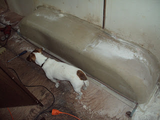

I see from your photo you have an assistant, is it a Jack Russell Terrorist? My 4 legged assistant does her best to hold the couch down when I'm working on the trailer.

Yes that's our jack russel terrorist Kees. Always around and wondering what i am doing to his playground.
