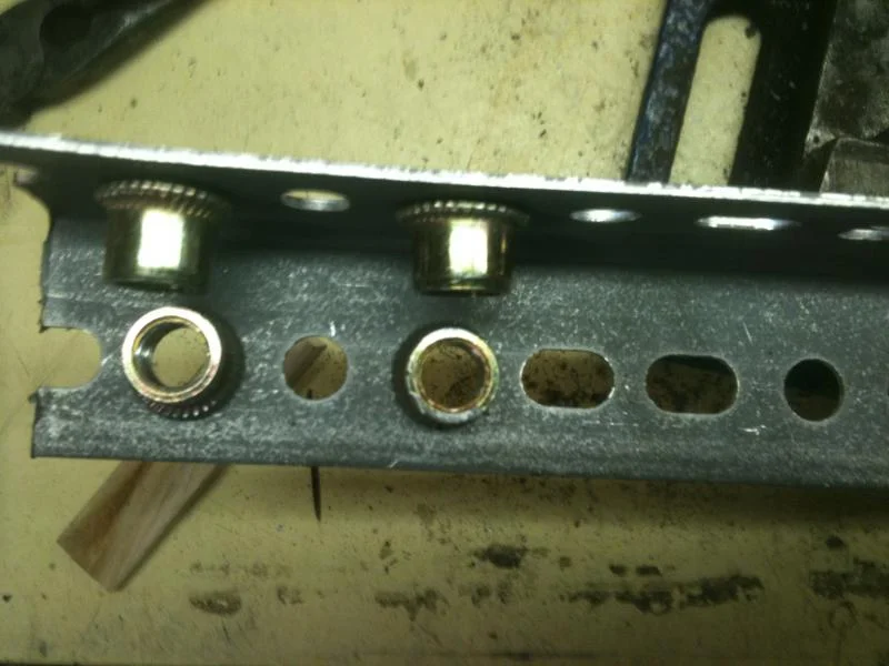

I have removed the shell from a 1963 Bambi, and I have to say, I don't "get it" as far as the advanages of putting elevator bolts back in.
Threaded Rivnuts are a little tricky to install, but pretty easy once you get the hang of it, and in this case they are not "blind" when installing in C channel.
When you figure the cost of flat washer + lock washer + nut compared to a rivnut the cost is about a push either way. A flat head screw with a drop of thread locker, would keep 'em tight, but still allow the bolt to be removed in the future and the floor plywood replaced, without dropping the belly pan.
Below is some practice for another project. Anybody see a draw-back to using Threaded Rivnuts instead of elevator bolts?

The head of a flat head screw is not as large as the head of an elevator bolt and does not distribute the stress as widely. Also, in the course of turning the screw while tightening, you may cut more of the fibers in the floor than you would with an elevator bolt.

Threading frame and cross members won't work very well on Vintage trailers - there really isn't much metal there. The problem w/ RivNuts is that you'll have a hell of time finding the holes if you ever replace the plywood.
