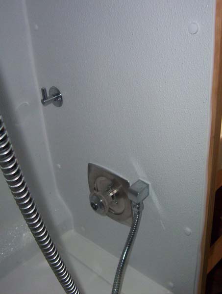

Great renderings for your bath Don, and the setup looks great for the space.
Not that I am suggesting anything for your shower head location, but I noticed Brad posted "Unless you want exposed plumbing, the curved exterior wall is out so that leaves the two end walls."
In ours, the plumbing is in the curved wall and not exposed. Is there a reason this isn't feasible in yours or why someone wouldn't want it located there? I can understand the logical part in a wet bath, not wanting to have the shower head pointed to the doorway. Just wondering why the pipes would need to be exposed.

BAH! It has been so long since I was in our AS, I forgot the plumbing isn't in the curved wall for the shower, sorry. The head is just mounted on that wall. The plumbing is in the side wall. You would think I would remember after building the whole thing this summer .
The shower head was mounted in the same spot before de-construction and it seemed the best spot to get the most height out of the shower. Since I am 5'10" and the shower pan is up about 4" off the AS floor as original, I wanted to get my hair wet. I just barely fit under the shower head. It comes off that hook in the ceiling and there is another matching hook near the seat (threw this in for a shower head placement).
Easy to see here:
With the wall in place (disregard the plastic covering the shower floor/seat):
Here is the hardware on the separater wall with the second hook for the shower head:

I like this a lot. Thanks for the pictures. What did you do to solve the problem of possible leaks down the road?
Don
Easy to see here:
