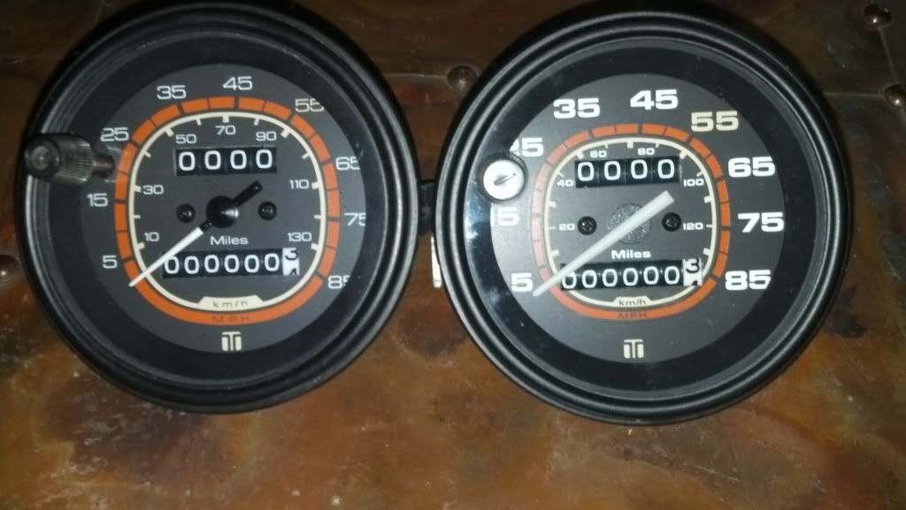

I feel the need... the need for Speed...O
My speedo, was not the original and so I was looking...
Was not sure which one was correct... so got 2...
One has smaller numbers and one larger... the larger will be going in.
Steve, I'm not sure the one on the right will fit in the 345 dash. The original gauges are fitted with shrouds that make them larger in diameter. I don't know that the shroud will fit that style of speedometer. I can check later today as I have one like you bought and I also have the original 345 gauges to compare to.
Stay tuned....

The first picture shows a different style of gauge than was originally used in the 310/345 series. The right gauge is from the 345. In the center is the sun shroud that slips over the gauge. The shroud requires a larger dash opening. I absolutely hate the shroud. It just makes it harder to read the gauge.
The second picture shows the sun shroud installed on the original 34 gauge.
The third picture shows it installed on the style of gauge that Steve wants to use. I found no difference in fit of the shroud on the old gauge compared to the new gauge.
If your speedometer is loose in the dash it's likely because the hot melt glue used to hold the shroud in place has broken loose. I believe this happens when someone tries to remove the dash assembly or loosens the dash assembly and tries to pull it towards the steering wheel. The speedometer cable doesn't have much if any play in it so when you pull on the dash you're pulling against the speedometer cable which then pulls the speedometer and shroud away from the dash. Both the 310 and the 345 had this same problem.
Hope this helps!
