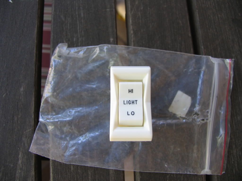

Replacement switch, I got lucky enough to snag from Idroba!
Man am I pleased cos I hear they are NLA...
What I found interesting is that it IS offwhite... I assumed my old ones were faded!

How do you get them off the wall, it seems that they are glued ?

Really?
I guess i will find out when i go to do it!

I'm missing a switch just like this and have a substitute one hanging out the kitchen wall waiting till i find one. Give us a holler if you happen to come by another.

On my 310 this switch is mounted on a comfort panel and you may have to take the panel off to get to it. The switch itself is held in by two legs top and bottom that's spring out when his pushed completely and because of the plywood backing and the material on the comfort panel it may be difficult to unsnap it. In my case the contacts were burnout because of the amount of current the that goes through the switch, I was able to find another switch and transplant the contacts from the new switch into the old. If I remember right that is a two pole switch and I believe I wired the polls together so that the contacts could share the current and hopefully it won't burn up in the future.

When I sold my 79, the new owner ask me to remove the entertainment center, which had 3 switches mounted on the side. I had no success removing them and finally just cut a 4x4" section, leaving them in place. Looking at the back, I noticed they were installed with large amounts of some brown adhesive. Not sure if it was standard or just some later fix.

I also need this hi/low switch. If anyone find some please let me know. I also need one white wall outlet.

On the subject of the Hi/Lo switch....
Mine is still working, just the action is soft with little detent between positions..
I inserted a small flat screwdriver under the lower edge and levered gently and it popped right out...
There are soft fit plastic tabs top and bottom...
The switch is marked:
UND LAB LIST INC
USA 311
10A 250 VAC
15A 125 VAC
3/4 HP 250 VAC
Pic.
