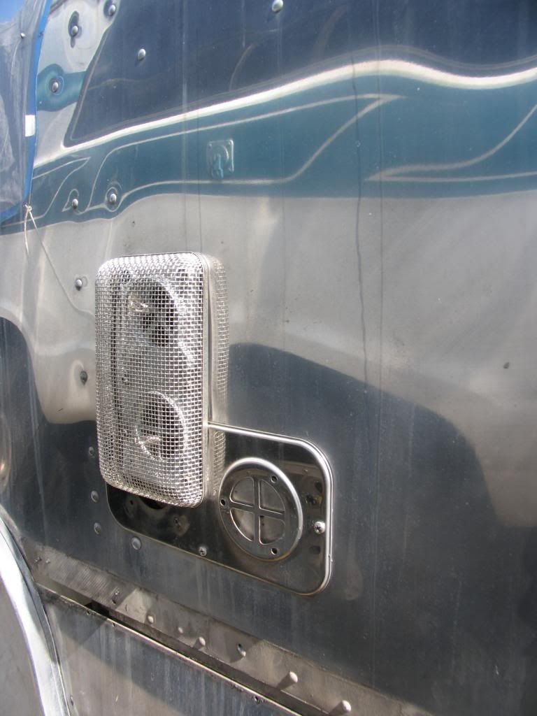

And put the Funace screens on...
should help keep some critters out!

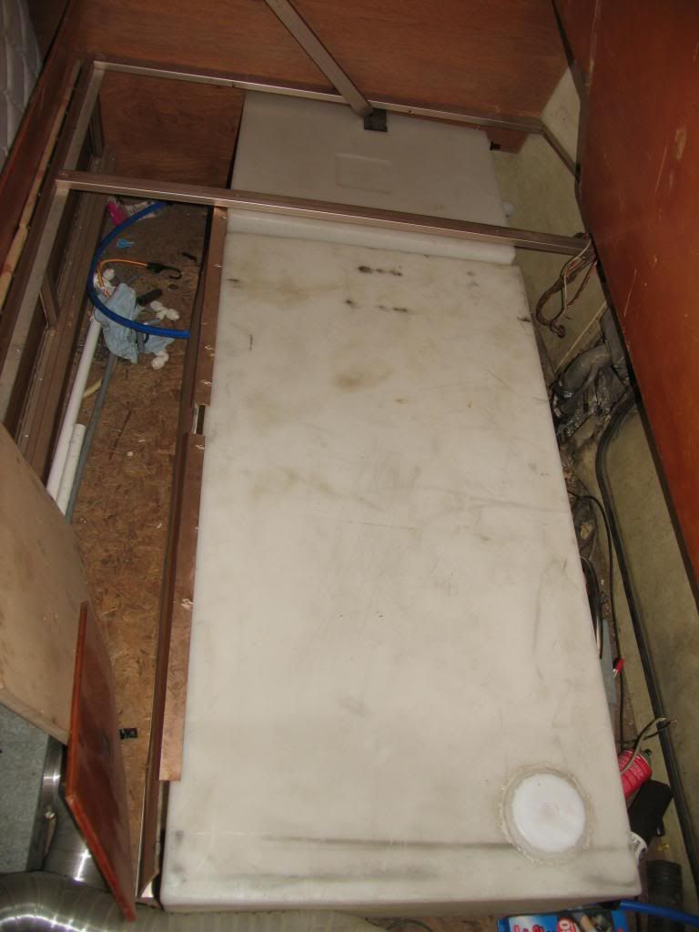

Tried my CL watertank in place....
Perfect fit!
This tank is 25gallons, thicker construction, and has the level senders already in!
As mensioned before, the 80gallon OEM tank was long gone, and all I had was a thin walled cheap 15g there.
The plan is to have the 25 as the travelling tank, and have the 70 connected by a valve, so it is not normally filled, except when needed for boondocking etc..
Test fit..

Not much to report as things have been busy with the new business, and family in town.
Did make some progress tho...
Perfect fit!
Test fit..

Put the hood and grill back on...
Steve,
Where did you get the rectangular furnace vent cover? I'd like to change out my two individual round ones for one like yours.
