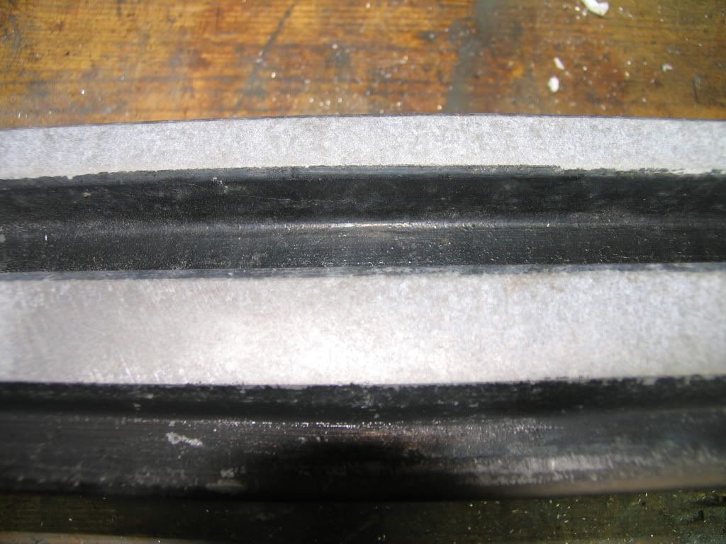

Got to work on the first Grill bar... I think its the upper..
The cast surface is very crusty...
Got it unbolted and on the bench..
Started with half the bar as a test.
Hit it with a DA sander with 180g then 220g, and it was looking better.
The upper bar has a 45deg above and below it running off the main suraface. The lower bar only has the 45 on the upper edge.
These were painted black, and only the forward facing surface was polished on ours.
I have decided to polish that too, and move the black painted areas back one surface to give the grill and more 3 dimensional look...
Test polish was ok, but not great...
You can see the 45 deg I mentioned better here..
Went back and wet sanded the whole thing with 800g, then repolished..
Much better... but had to stop an my bench buffer was getting hot and smelly... I think its on its last legs!

Trying to get the center part and lower bar seperated today, but the bolts are in bad shape... looks like I am getting the grinder out, as PB Blaster overnight failed me...
Missed some more pics of upper...
This pic you can see the little 45 deg that was painted before, that I decided to strip and buff...
Old 01-13-2013, 04:55 PM   #1145
Posts: 3,513
Had to cut the bolts off to seperate the lower from the center grill.
Sanded out the crud, working down to 800g wet,
and got it polished up.
Got is painted up, just need to clean up some ragged paint edges..
Look at the comparison between restored upper bar and untouched lower..
