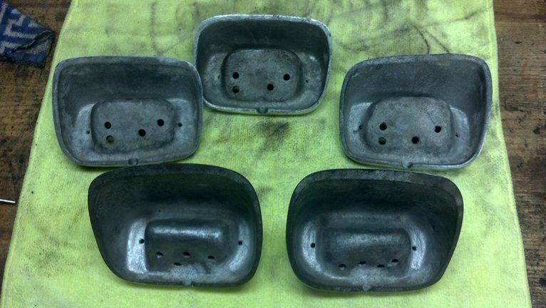

Next time I am over at the MH, I want to get the marker lamp casting back on...
Looking at them on the bench last week I noticed a "Weep Hole" in the lower edge of each one..
My question is when sealing/caulking the castings to the roof, should I leave it open and risk water being driven into the hole when driving in rain, or close it with a bead of sealant and risk condensation or pooling of water?

My feeling is the weep holes are there for a reason. I treat them the say way I do windows on a house, caulk the tops and sides and leave the bottom open so moisture can escape. If you don't they will condensate on the inside anyway.
After tearing apart the 345 and seeing how the wire access holes were so heavily sealed with vulkem on the inside I doubt that you even need to worry about caulking them anywhere.
JMHO

Thanks for the input Brad!
Seems logical, and having thought about it, I was leaning that way!
