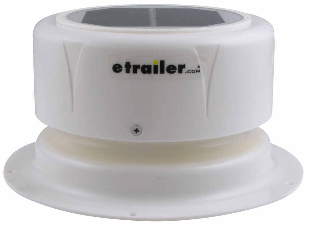

Yes, and they work great, I have two in Bella - one pulls in, one pushes out and they really generate a breeze inside. The issue is they only work if the coach systems are left on, so fine if plugged into shore power. The little solar units run whenever there is enough light to drive them.
http://www.etrailer.com/RV-Vents-and...FQxahgodwVcGPw
martin300662 is online now   Reply With Quote
Those solar fans are surprisingly cheap. I might have to consider adding one to mine. I haven't figured out what to do about a bathroom vent yet so this could be the answer.
