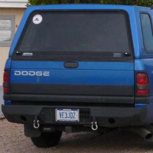

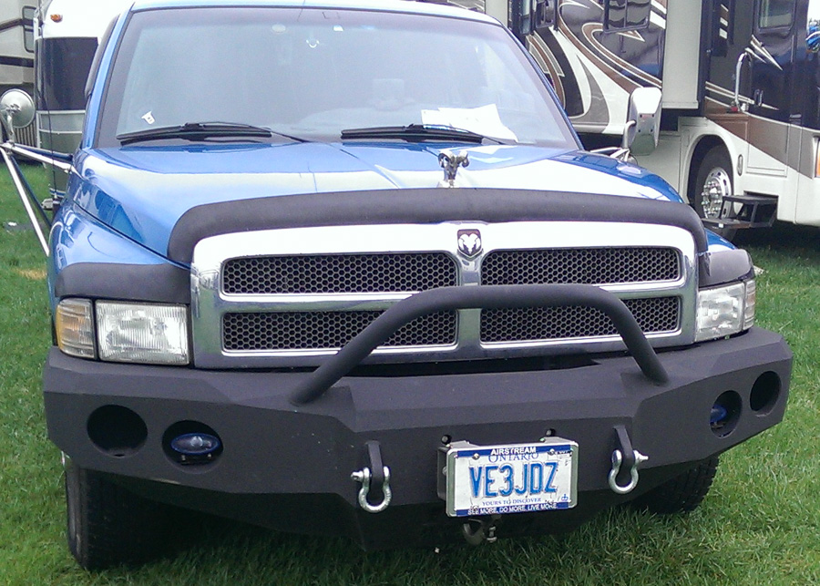

The breakaway cable should not be attached to any part of the hitch receiver. I had originally swapped out one of the bumper bolts on my TV for a stainless steel eyebolt. However, after having issues with the OEM bumpers on the TV, I replaced the bumpers with a set from Iron Bull, and attached shackles to which I clip the breakaway cable. The bumpers BTW are made of 3/16" steel plate and are bolted to the frame.

terryV - A bit of history that led up to these bumpers. .
I was at a rally where I was parked on lush grass just as rain stopped. In trying to get to my allocated spot, I got stuck. The host had a farm tractor and an appropriate strap. However, the TV had no tow hooks, so he wrapped the strap around the middle section of the front bumper and hauled me with the AS to the designated parking spot - about 100 feet or so from where I was stuck. Unknown to me was that while the bumper face was metal, the backing was all plastic, and it cracked. Before long while I was driving, the plastic was flapping in the wind. When I priced replacement OEM bumpers, the cost was just slightly less than getting the Iron Bull ones.
The bumpers were shipped in on a pallet. It took 4 guys to attach the front one - they are welded 3/16" steel plate - no piece is bent or curved, the whole bumper is flat plate cut and welded to shape. Since the front bumper had provision for a winch, I bought a 12,000 lb winch and had it installed. The TV is only a 2WD, so the winch ensures if I get stuck again I can haul myself out. I also found a neat stainless steel flip-up cover that holds the front license plate.
Cool. Any idea how much net weight you added to your TV when you did this?
Bob Martel
