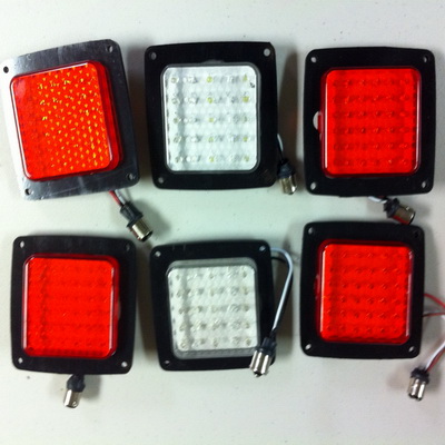

nice
Check this thread I started a while back. We have a 1984 Sovereign. Got mine from S&S LED's. Pic on the last post. And here is another pic. They work really well, and I am ok without the red border around the backup lights.
http://www.airforums.com/forums/f447...e-83527-2.html

Old 12-04-2011, 10:42 AM   #13
CASA3805
casa3805's Avatar
1984 27' Sovereign
Corpus Christi , Texas
Join Date: Mar 2011
Posts: 651
Images: 30
Joshua,
I went to the site you pm'd me and then checked measurements against the old ones that came out. I think those will be too big for you. But the ones posted right above this look good. Especially if they are now a sealed kit. Not sure about the plug on the end of the wires, I had nothing like that behind mine, it was wire to wire splice.
Here are the pics with my old ones so you can check measurements. Depth was fine, but I think the lights were simply bigger.
ID:	146477   Click image for larger version
