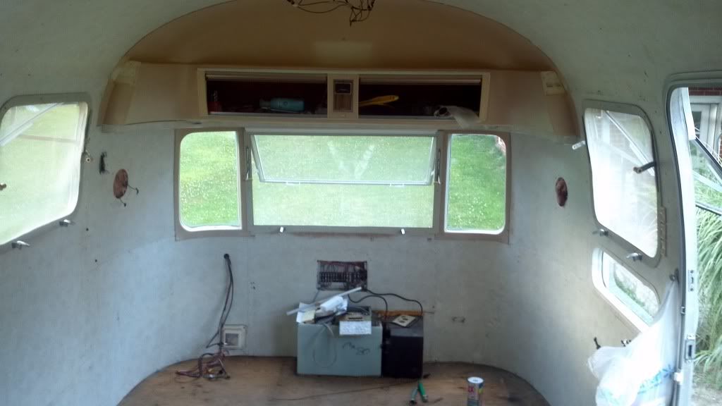

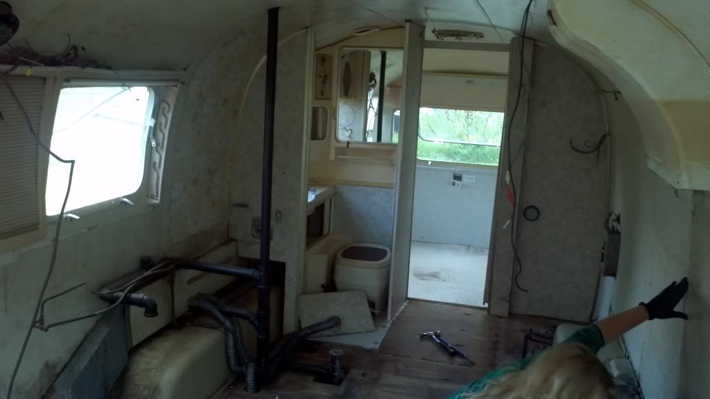

Also, I'm starting this thread a couple weeks into the gutting phase:
Front of camper.
Rear of camper.
I'm planning on doing a shell off restoration. I'm a huge fan of knowing exactly what shape the 'StreamDream' is in. I'm a newbie to the airstream resto game and I'm going to need all the help I can get. The scariest part of this process is figuring out the order to do everything, so my first question is: Once i finish gutting the inside, what should be my next step? Upon completely clearing out the interior, is there an order of operations for getting to the shell removal? For what it's worth, I'm planning on lifting the shell from the top using gantry cranes.
Any and all suggestions are welcomed and appreciated!

Removed the exposed copper and avb drain/vent pipes. Saw a wicked hole in the floor that was previously covered with plywood by the PO. See below:

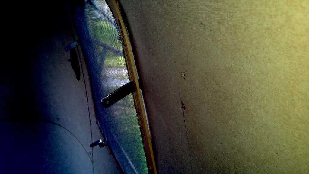

After removing the rear walls, i noticed something interesting about one of the rear windows. Apparently the PO replaced the screens but didnt reinstall the windows properly:
Yup, thats light you're seeing between the wall and the window trim.
