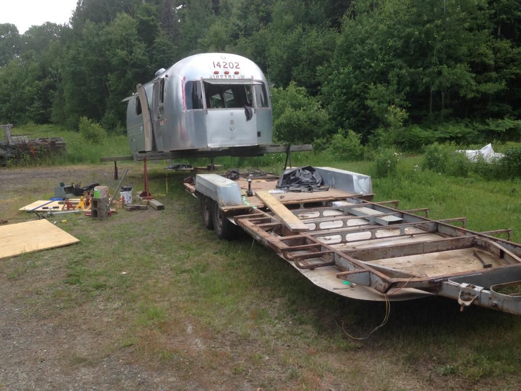

Hi Everyone,
I've just purchased my first Airstream. Its a project to say the least but one that I'm certainly excited to tackle. I've brought it home and cleaned it up but want to do things right as we plan on keeping it for as long as possible.
First step is to take over where the previous owner left off and redo the floor. I'm working through all the posts and am also hoping for some insight (or warnings) from your experiences as I paint the frame and replace all of the floor. I read the posts about using gantries and should have listened. Lets just say I went through a little "separation anxiety"...at least everything is still wrinkle free.
Here's a few pictures so far.

It looks like you've got a pretty good handle on what is involved in a "body off" floor replacement, however the only thing I'll caution you on is the precarious position of the body. Take some time & lower it to the ground & tie it down somehow. These bare bodies have a tendency to "fly away", destroying your dream.

Thanks Kokopat and Colin. I have dropped it down and hooked straps to the interior ribs with the other end tied to concrete filled cinder blocks, the 8x8's it's sitting on, and a picnic table...I am a bit paranoid now though. Kokopat, I will start a blog shortly.
I do have a frame related issue before I start that. It seems the worst place on the frame is centred around the step. Is there anyone making replacement weld on parts for that area? I'm hoping for the piece of channel at the top. If I do have to make my own, can someone send me pictures of theirs? Here is what I have now. Click image for larger version

You are in the right spot. Keep posting pics and documenting your progress as above. This keeps it all in one thread that is easy to follow.
I recommend you sandblast the frame. Then you'll be able to fix any areas that have rusted through. The step areas you have pictures of are pretty common. Cut out the rust perforation, shape/form and weld in new metal.
Good luck and keep up the good work!
