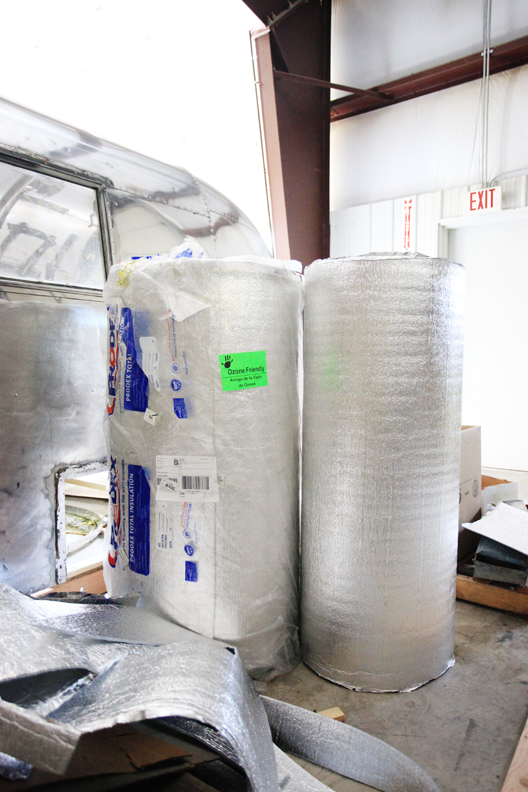

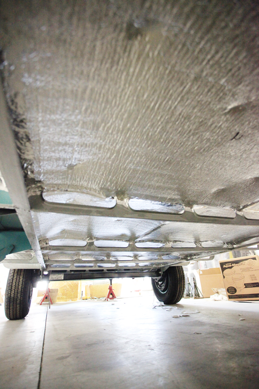

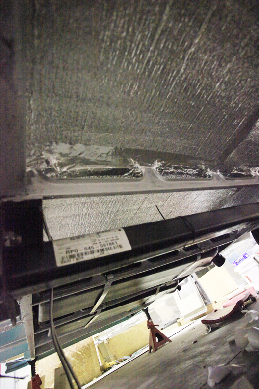

The first layer of Prodex insulation is in, we added air conditioner supports (two new partial ribs and several straight pieces), the 120 volt wiring is in, and part of the 12 volt is in. The green is where we added some heavy duty aluminum bent into a C shape.

Suggestion...as you add the second layer of insulation and the interior skins, mark where the wiring is located so you don't drill into them. A sharpie works great and will wipe off of aluminum with MEK.
