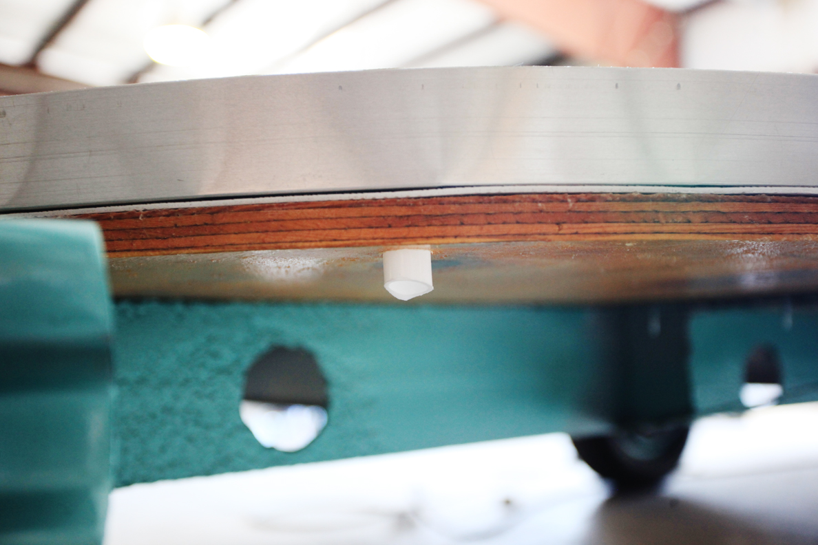

With the newly bent J-channel waiting for me at the shop, I made the curves with a pair of tin snips. This turned out to be very easy. Not sure why I was so afraid of making new j-channel.

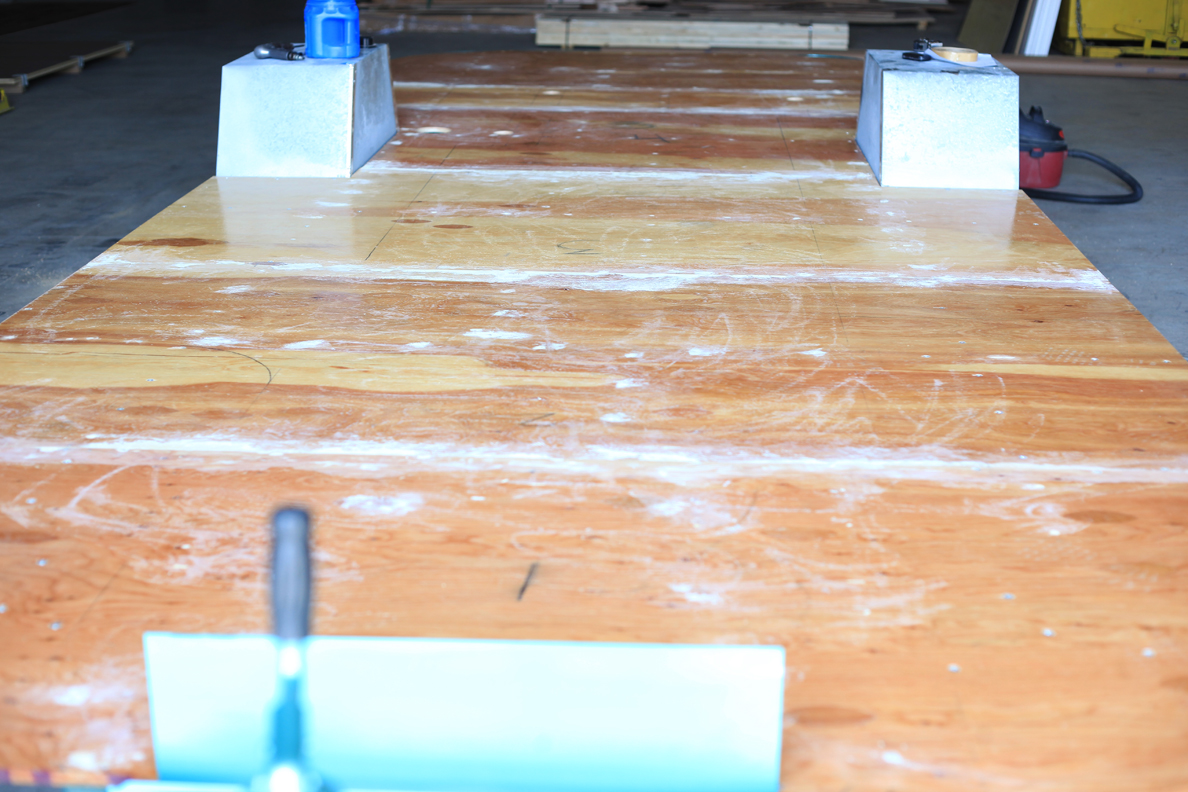

After filling the cracks between plywood pieces and over the screw heads with wood filler, I sanded (with a belt sander, otherwise it would have taken forever) everything smooth, swept and then wiped it (somewhat) clean with a damp cloth.
Back up a few days. To add support to the plywood step, we added two steel angle brackets. One right on the edge and one six inches or so back, with a layer of aluminum to protect the underside of the plywood from water and dirt, since the belly pan will not cover it. Both kinds of metal are painted to prevent rust.
I kept thinking of all the stepping that would happen in that one spot and decided it needed to be reinforced to prevent the plywood from sagging later on.

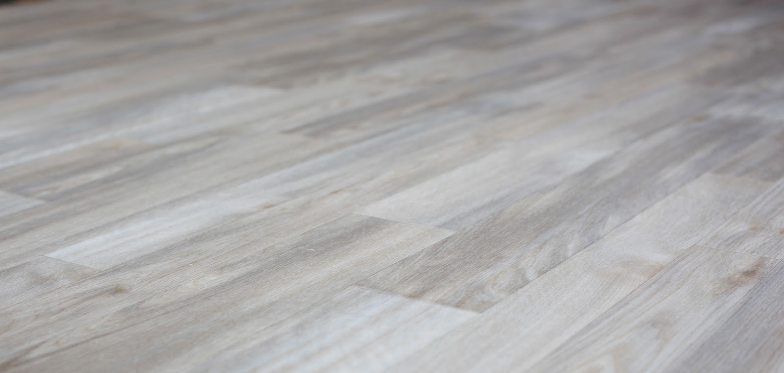

Back to today. The holes for the toilet and shower were drilled, then the new flooring went on.

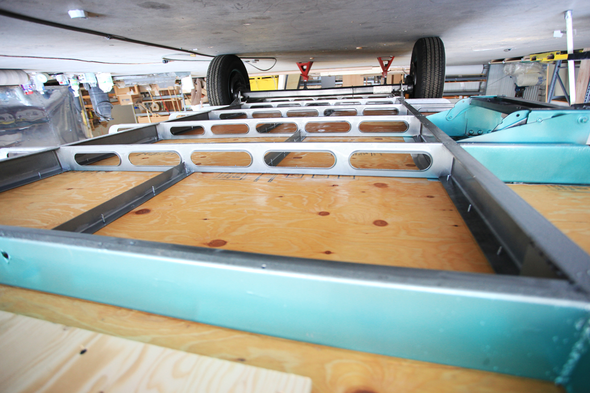

The shower pan is about 3 weeks away and there is so much to do in order to be ready for it. Tomorrow, I insulate the under side of the floor, screw down the j-channel and then go to Dairy Queen for their "happy hour" slushy special. Anybody want to come with?

While you can still get to it I would suggest sealing the wood as much as humanly possible where the shell will sit on it (between the C channel) I used close to two gallons of polyurethane to build up a large protective barrier. This maybe overkill, but it sure felt good to see the water make a puddle instead of soak in when it rained and I hadn't gotten the last patch on yet!

Eric H - I'm with you on that! I coated the plywood with West System Epoxy on both sides until completely saturated, then added another coat. I would love to see what the floor looks like in another 50 years and see how well everybody's expensive, time consuming, stinky glues held up!

All of the channel is screwed down and each screw head is covered in silicone to prevent leaks and/or condensation from soaking into the holes and rotting the wood underneath.
Next, I added four plastic drains (one on each curve) and sealed off any gaps in the channel.
This way, if the outer shell ever does spring a leak, the water will flow down these tubes and out of the belly pan.
I haven't decided whether to add a flexible tube that would come out the bottom of the drain and send the water out a service panel on the bottom.
