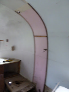

Evidently at one time our bathroom was Pepto Bismal PINK! This is what we found at the back of the closet! I'm guessing it didn't go over so well with the hunting buddies!!!
