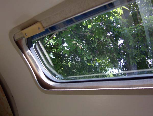

I finally ordered the gaskets for the Vistaview windows last week from Can-Am. The tint peeling in between the panes is too much to look at every day. The gaskets arrived and are rectangular from the side to fit in the area left by the inside pane you break and remove. I decided to try one this weekend. It was suprisingly simple to break the inside pane of glass and pull it all out. I went super slow so as not to break the outside pane and it only took 1 hour to get the one window done. This included cleaning the frame and window, resealing with Vulkem and putting in the gasket. Below are some shots from before and after...
Before:
With the pane broken. I used clear tape over the window so the shards didn't fall all over the place:
After it was all over:

    Thanks. Call Cam-am RV in Canada (Can-Am RV > Home) on the gaskets. There are different types of Vistaview windows and some come apart to clean, others like ours are sealed and have to break out the inside pane. They can make sure you get the right gasket.
    Since ours were the sealed kind, we broke out the inside pane, cleaned up the track really good, cut out the rubber seals in there until the outside pane was loose in the frame. Then put Vulkem between the outside window and the outside edge of the track and push the inide of the window pane to reseat to the outside. I then put another bead of Vulkem on the inside, where the glass meets the frame and inserted the gasket. We will see if it keeps water out

    You made this look easy. How did you break the glass so as not to break the outside glass? I'm going to attempt this project this weekend. And...how is the seal holding up to keep water out?
    Posted 02-08-2010 at 10:08 PM by adwriter73 adwriter73 is offline
  4. Old Comment
    Adwriter,
    I sent you a PM with details but if anyone else reads this, we used a flat blade screwdriver wedged in between the inside pane of glass and the frame. Then tapped it in with a hammer, light, little taps. Once the glass goes, you will know it. I was just real cautious (more than needed probably) and took my time. It really doesn't take much time at all though. 45 minutes each on the last 3 maybe? I broke them out in September 2009. It is now February 2010 and we had 2 really hard storms with sideways downpour as well as about 34" total of snow (14", then 14" then 6"), most is melted and still no leaks except one that popped up mid-winter around the AC. The seal probably need replacing and isn't a big deal. We found a little puddle on the epoxied floor after the largest rain storm (maybe 2" X 2"). Felt around the AC cowel and a little more settled inside there. Will have to take it off and re-gasket this summer.
