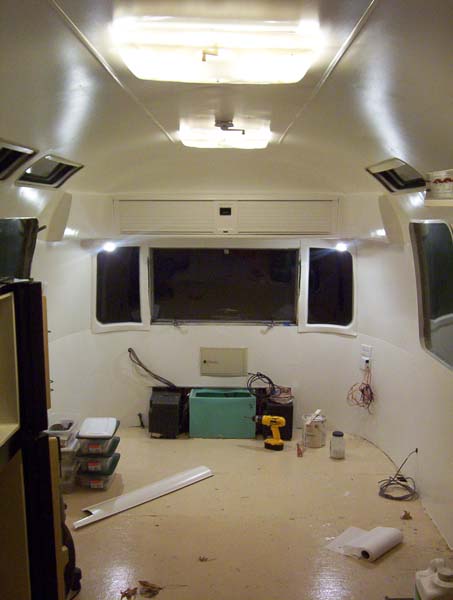

We finished the painting sometime last week and put all of the ceiling lights, outlet covers, AC cover, wing window trim, end cap tambours, etc. back on. Below is some picts of the paint inside:
The front end:

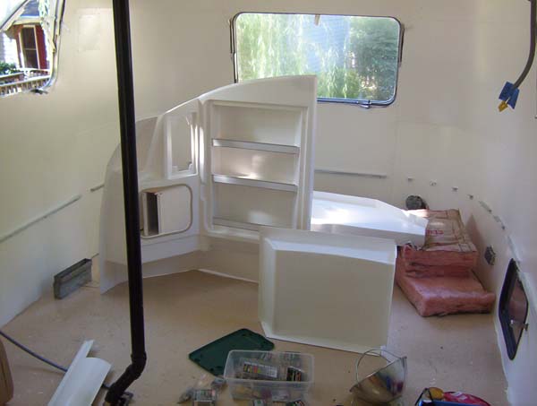

I need to take a daytime picture of the front end. I am pleased with how the primer/paint stuck to plastic and vinyl and the color looks great against the pine wood and blue materials that will eventually be inside.

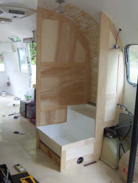

This week we worked on re-making the bathroom. I started with the wall between the shower and kitchen since one side is hidden with shower board and the other will have another wall in front of it covering vent PVC pipes. I wasn't worried about grain direction or the handling of the round corner for this wall since it wouldn't be seen but did want to practice making good, solid tongue and groove framing with floating panels of pine paneling and make a sturdy mounting area around the curved wall for the shower board. The paneled walls are a little lighter in weight than the thicker, honeycomb walls AS used inside our camper, but a little heavier than the straight panelling walls. Here is a picture of the first wall just sitting in position before sanding and polyurethane:

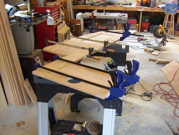

Next was the wall on the other side of the shower where the opening into the shower is. Here is a picture of it clamped up for drying (and my messy shop):
You can't see the right half of the shop. It is chock full of the old interior as well as some of our yard out in front of the shop.
Here is that wall just sitting in place after getting the curve to fit:
The hole at the bottom is for the heater vent. We are reusing the brown one that was in there but mounting is on the back of the board for a recessed vent.
That is all of the pictures we have so far but we did finish making the wall between the bath and bedroom as well as both hall walls that go in front of the shower and toilet and make the opening into the bathroom. They have been finish sanded and the shower board cut for both side walls. I will say, the square walls went together fast. The rounded walls went back and forth to the shop 4-5 times to get the curve shape just right. That is even after using the walls that came out as templates and making sure they fit back in before hand.

The front end:
The rear (bath plastics are in the way but...):

We used Sherman Williams paint and primers for the camper mostly. We first cleaned the walls with Marine Clean from POR15 guys, then sanded everything with 220 grit sandpaper heavily and wiped again with slight soapy water.
The endcap was primed with a product called "Adhesion Primer" in Latex (B51 W 8050). The guys at SW said anything will stick to it and so far, they were right on what I primed with it. The paint stuck well to all surfaces. I used that for the front endcap and tambours, the wing windows surrounds and the AC cover. The vinyl walls were primed with "Pro Block" oil-based paint (B79 W 8810). Both primers were white in color and were applied using brush and roller. We then painted all of it with an Alabaster color oil-based paint applied with brush and rollers. I brushed the entire front endcap due to the curve in it but the rear curve, I used a roller cut into 1/3 size and a small roller. I was very cautious with paint drips and runs with the uneven aluminum seams and kept going back every few minutes and checking the previous area, re-brushing where it ran.
It has only been painted for a week and a half now but I have ben quite abusive while I put in and removed the bath walls over and over trying to get a good fit and hit them numerous times (not intentional of course) and the paint hasn't been marred or scratched which to me is a great sign. Seems that it will be able to take some abuse well.
I will say though that having everything out first helped tremendously. I wouldn't have wanted to mask and paint around furniture. The epoxied floor was done first and is now covered in paint drips. In our case, it doesn't matter since the floor will be covered later.
