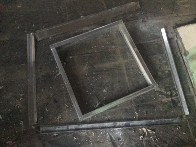

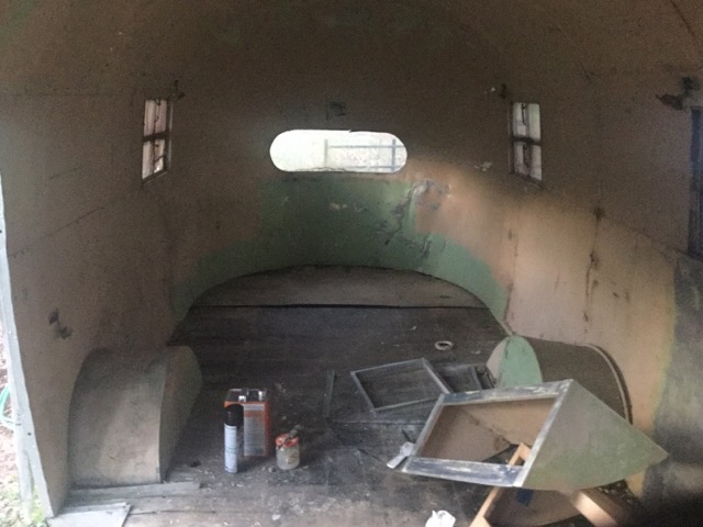

We spent the weekend just seeing what we had in more detail. We gutted the inside, saving the pieces not rotted, hauling the springs from the mattresses, hot water tank, etc. to the dump. We pulled on window out to get pictures of the 'w' piece for the hinge and the 'u' channel. We also pulled off one interior window trim and vent trim.
We then stripped paint from one section of wall, the one window trim, vent trim and one overhead cabinet. We wanted to see the condition of the aluminum. Not bad for the most part except the wall. This was where the stove, water heater and the worst window leak was. A lot of oxidation.
