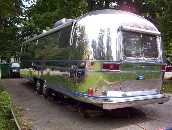

Well, we continued on our polishing of the other half of the Airstream last week. We have the roadside and rear end to complete. The roof is polished and we got almost all clearcoat stripped from what is left to polish. The roadside is about 2/3's polished as well. The picture below was taken before the upper portion was polished all the way to the rear endcap.
